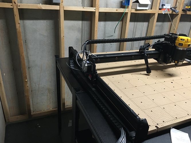

I didn’t take many “during” photos but we were able to build the Y axis, belt everything (need to check tensions at some point), get the basis of the Z axis mounted and skipped ahead and mounted the Y axis and gantry assembly to the waste board/frame.
I’ve got heat shrink on the belts and some electrical tape as well…hopefully it’ll help hold it in place.

I believe that I’m basically done with assembly now. It took a good effort last night and today but all that’s left is wiring the Y1 motor, all three homing switches and connecting up to the Gshield until the Xcontroller ships.

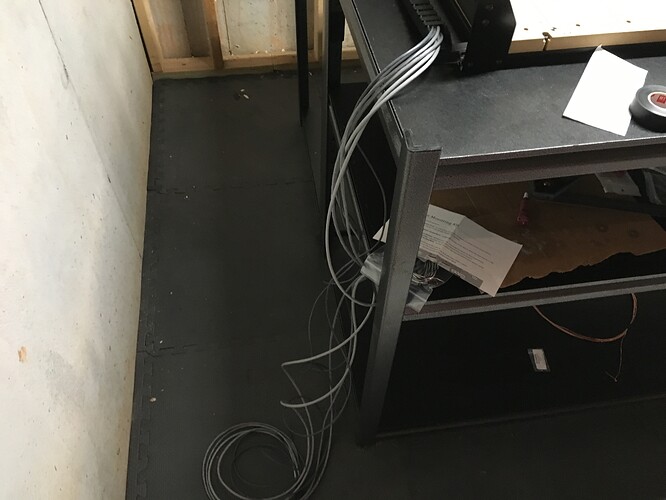

And now just some pictures of the overall progress and wiring and such…I have quite a bit of excess wire to trim up but that’s what I wanted so it’s all good.

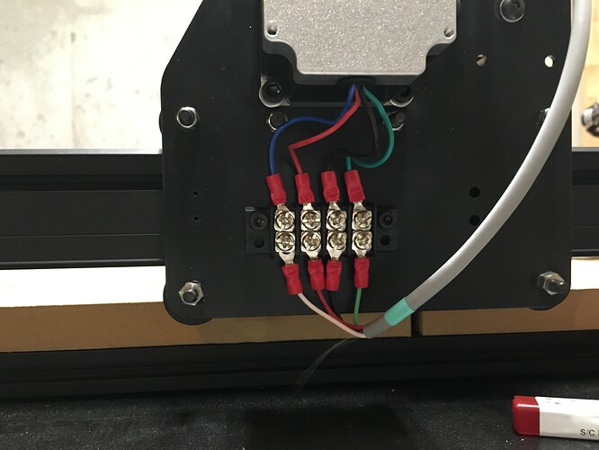

The stepper wire on the right goes through the hole in the stepper plate? here is a pic of mine
Just noticed you have a stiffening mod, maybe that’s why?
Yea the bolts take up all the available space. I’ve got the new single piece X axis coming in once it is released so I’ll feed it through then. I tried to get the wire to go but it just wasn’t possible.
It’s down in a channel of the makerslide with electrical tape over it holding it in place (not very well). It’s out of the way of the X carriage though.
