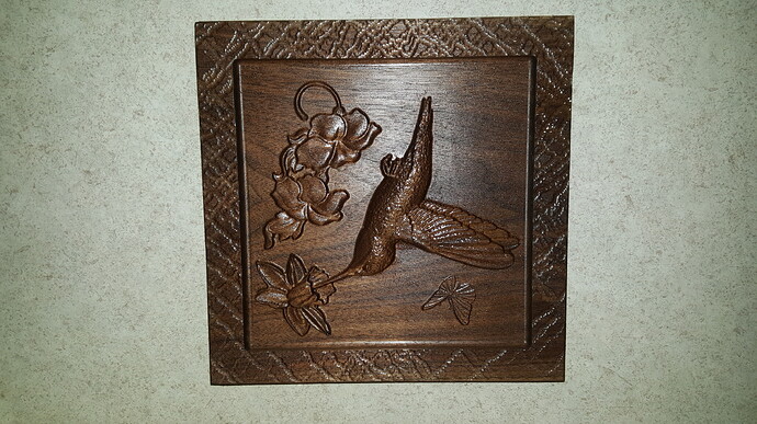

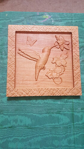

Any idea what this is worth? Done on an 18" edge glued pine.
About 22hrs to complete

Looks good! 22 hours…WHAT?!?
Looks really great, but did it really take 22 hours to carve? You should be able to go faster than that, especially if you do a roughing pass with a bigger bit.
doesn’t even need roughing.
parallel finishing at 1500mm/min
30 minutes tops
30degree .004 flat engraving bit, 50% stepover (.002) @ 160 ipm.

Any idea on value?
I did this sign for our house and had someone say they wanted one and would pay 100 for it. Depends on where you are located and what the interest in it is. I would not have thought my sign would be worth more than 30-40…but hey, they offered an amount…
I would guess somewhere between $60-80, depending on how elaborate the finish would appear / overall appeal.
