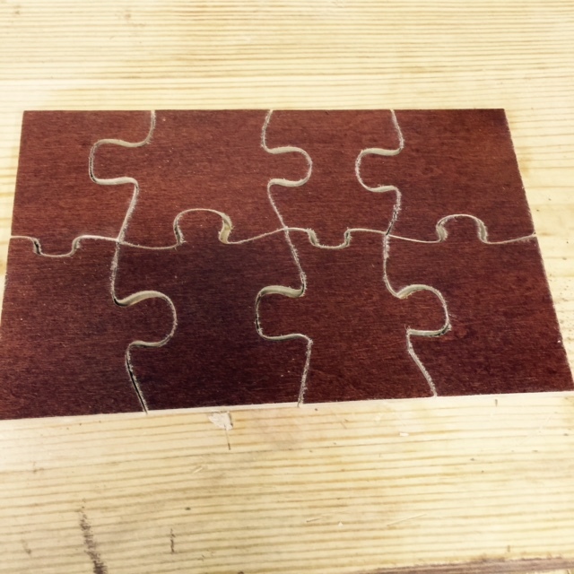

I am trying to make a simple jigsaw puzzle (8 pieces) and I have the puzzle laid out in Vcarve with each piece separated and a profile cut around each piece set to cut on the line using .125 inch bit in quarter inch stock

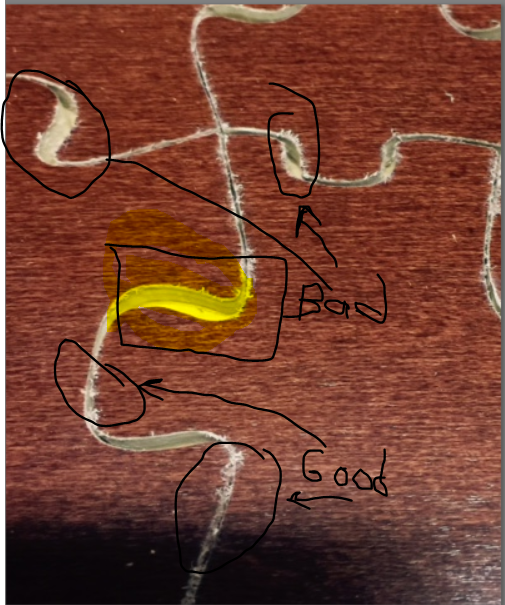

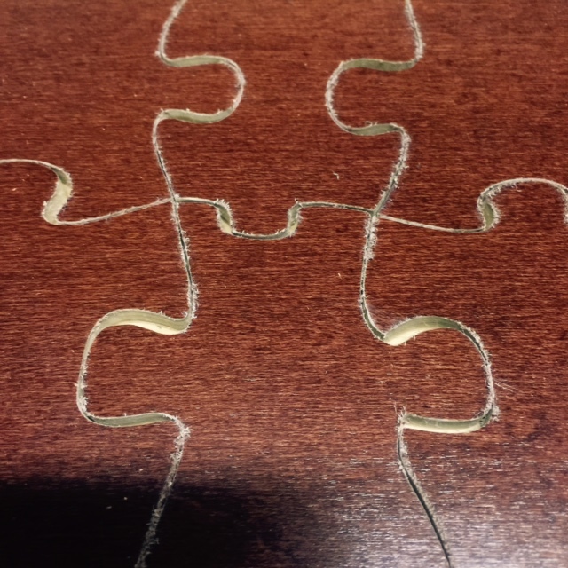

The results are not as good as I had hoped, Sure areas fit together very nicely and others areas have fairly large gaps
When I tried to do the profile cuts as outside the line cuts it was even worse.
It appears that the largest errors are in the portions of the puzzle with the highest curvature, so it may be related to bit size.
There must be some technique I am missing. Any tips or suggestions would be appreciated.

The “on the line” profile cut is perfect except for the high curvature portions The outside cut did not fit at all.
This is the “On Line” cut

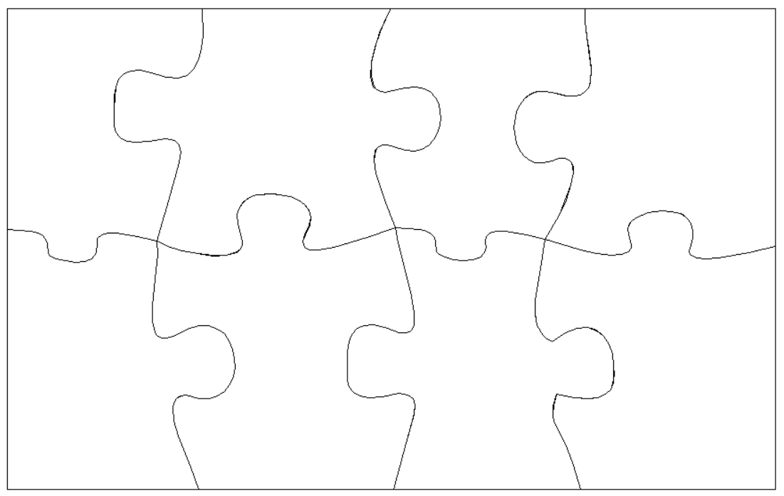

Here it is, there are two layers one with the broken apart pieces and one with it all together,
puzzle.crv (526 KB)
This is really puzzle, lets work on it.
This separated pieces are not matching to each other. Do you have uncut drawing.
Yes the uncut version is on a separate layer

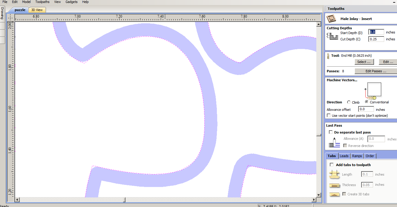

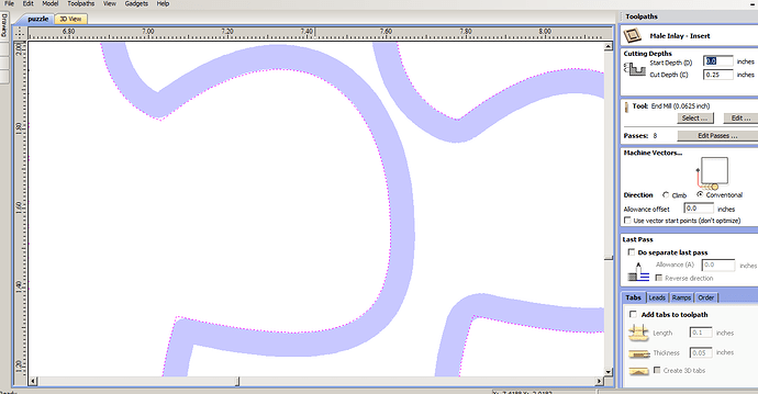

you shouldnt have a problem using a 1/16" bit, here is what the tool path will look like with a 1/16" bit and male inlay toolpath
as you can see it automatically adjust the sharp inside corner of one piece to fit in the sharp outside corner of the mating piece.
ahhh scratch the male inlay thing it wont work either. forgot that it will also round outside corners which will lead to this
