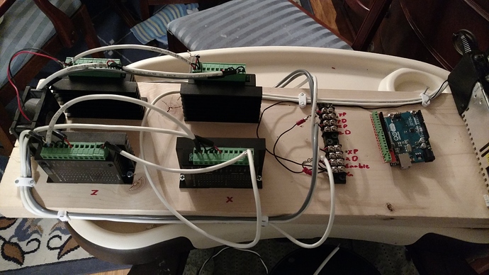

Ok trying to tackle this controller and I thought I had it until recent posts. Few things I want to check to make sure what I am doing is acceptable.
What I have so far

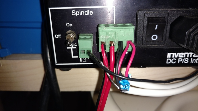

Seeing the grounding post got me concerned, I am running ground and power from the original DC interface. V+ and V- going to the VCC and GND on the drivers. The shielding ground wire, pul-,dir- and ena- going to ground on the spindle section of the interface.
When I was wiring I went from V+/- to the first steppers VCC and Ground, then I used another wire to go from that stepper to the next steppers VCC and Ground. I used that same strategy for the Ena+

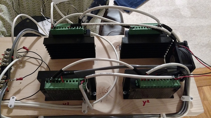

Slightly closer look
Anything I should be concerned about. At this point, I guess this is a check my work.

Any problems with daisy chaining the power cables? Aka do I need to order some more barrier strips? I will switch the ground to the Arduino instead of the DC interface.
Daisy chaining the power cables between the drivers are usually not recommended. You could add a capacitor for each at the input terminals to act as a buffer. 1000uF 50V for instance.

  1. Why do you bridge the PS grd and Ard grd at TB4-1 and 2? As just mntioned, shouldn’t the signals go to Ard and power go to PS grd?
  2. What are the terminals marked “To x MTR SHLD” on TB5-1 - 4?

AH! I wondered where those drain wires went. Awesome. So no drain wire from box to motor / switch but yes once inside the box? Any reason? Any harm in having all motor and switch cabling have drain wires?

Even if it is not connected to the motor / switch?
Not only does it lose its effectiveness. It will create a ground loop. That will intensify the EMI. = the craziest stuff you’ll ever see your machine do.
Yes. The only wires that should go to DC ground V- are the negative power wires for the steppers. The arduino, homing switches, pwm signal, touch plate and drain wires on the shielded cable should all go to earth ground. (I may have missed something. Someone else will remind me if I did.)
