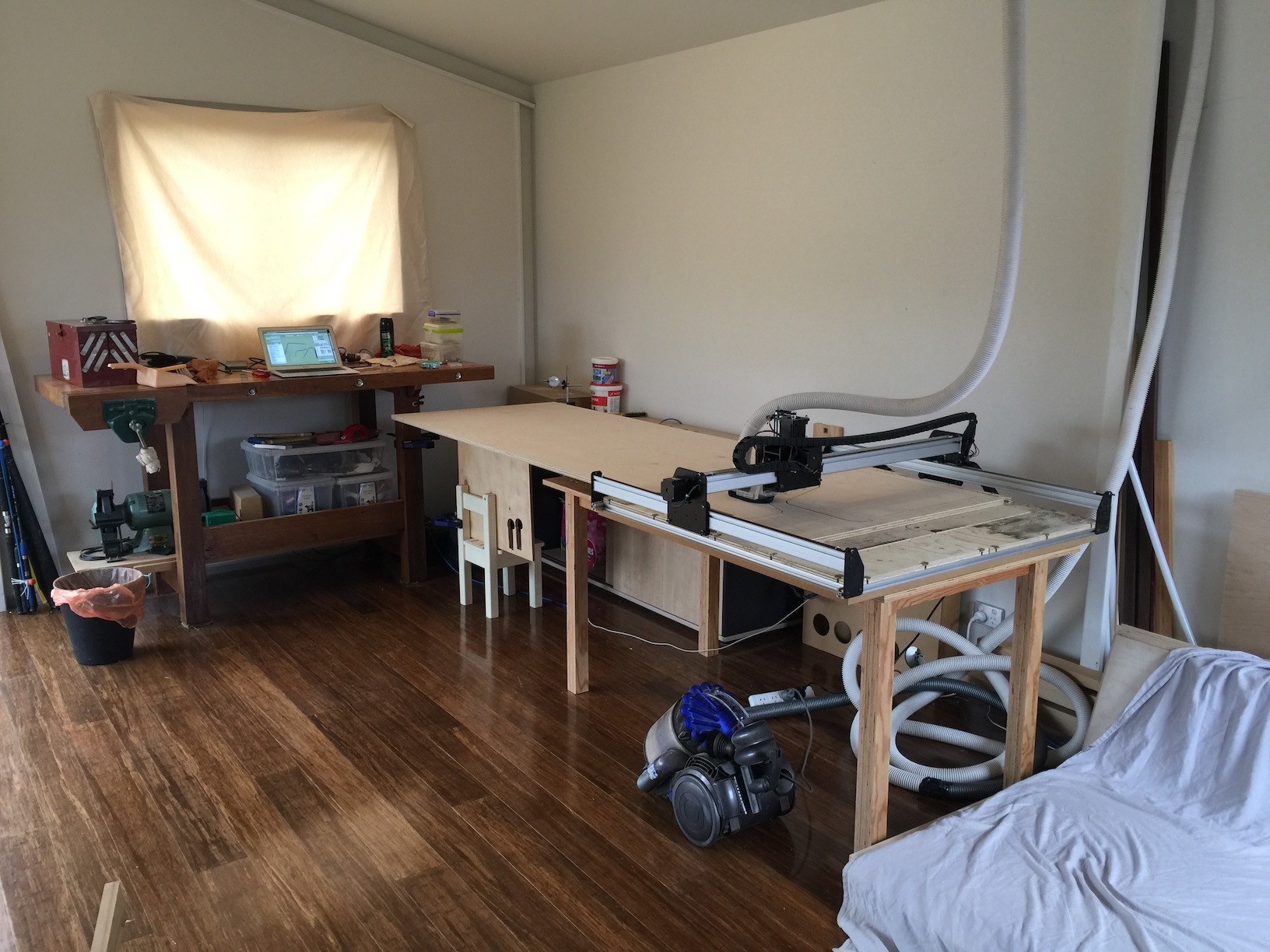

There is support on the way in to the x-carve and once the work started overhanging towards the back I had a similar setup there too.
The grey sheet covers the uncut sheets of plywood. Once a cut was finished I would lift up a new piece onto the back of the x-carve table, then slide it towards the front.

As you can see the room where the x-carve is is a multi-purpose room. My wife and I both work in there but it’s the only place I can do my woodworking.
I can’t have big machines in there or anything that requires a lot of clean up afterwards. The x-carve has been a way for me to do woodworking in a small space.
