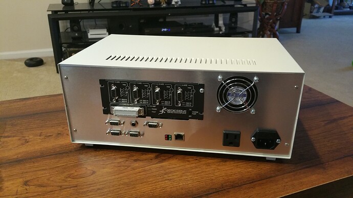

4 - Since GRBL does not support a rotary axis I had to replace the electronics. I went with a Gecko G540 and an Ethernet SmoothStepper as well as a Gecko G251 to add a fifth motor controller. I bought a fully assembled controller this time from http://www.camtronics-cnc.com/.
5 - And again, since GRBL does not support a rotary axis I had to change software as well. I went with Mach3 to control everything. I tweaked one of the Mach3 Interface screens so it worked better with my process and larger monitor in the shop. Here is Mach3 and the Controller all wired up.
