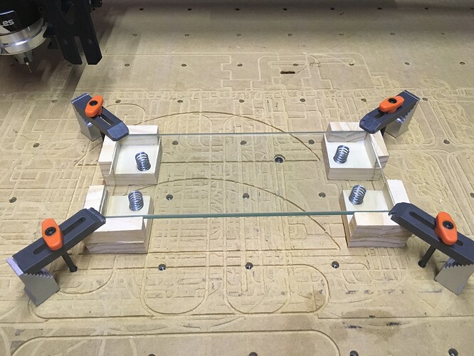

My test to carve & etch glass with the X-Carve
I saw the video in YouTube of the test with floating supports and I made mine, use a dremell bit andt worked! Sorry for the sound is strident but when you have worked with glass before you get used to listening to it.

This is cool!!! I like your hold down design. Please tell me more about the type of Dremel Bit you used
dremel 9924

is that a diamond tip? If so doesn’t that have a spring already in the shaft?
yes @BrianHoelscher1 I’ll iluminate it!
thanks @PhillipLunsford!!!
@anon68752607 is a $5 bit, dremel 9924
Its a diamond tip, not a diamond drag bit.
Intended to spin hence no spring.
I see. But in the video it’s not spinning that’s why I was confused. :sweat_smile:
I had to look too LOL :wink: But afaik its a regular diamond bit, but not spinning in this case :joy:

@CristhianPena. How strong are those springs? How much movement is necessary?
