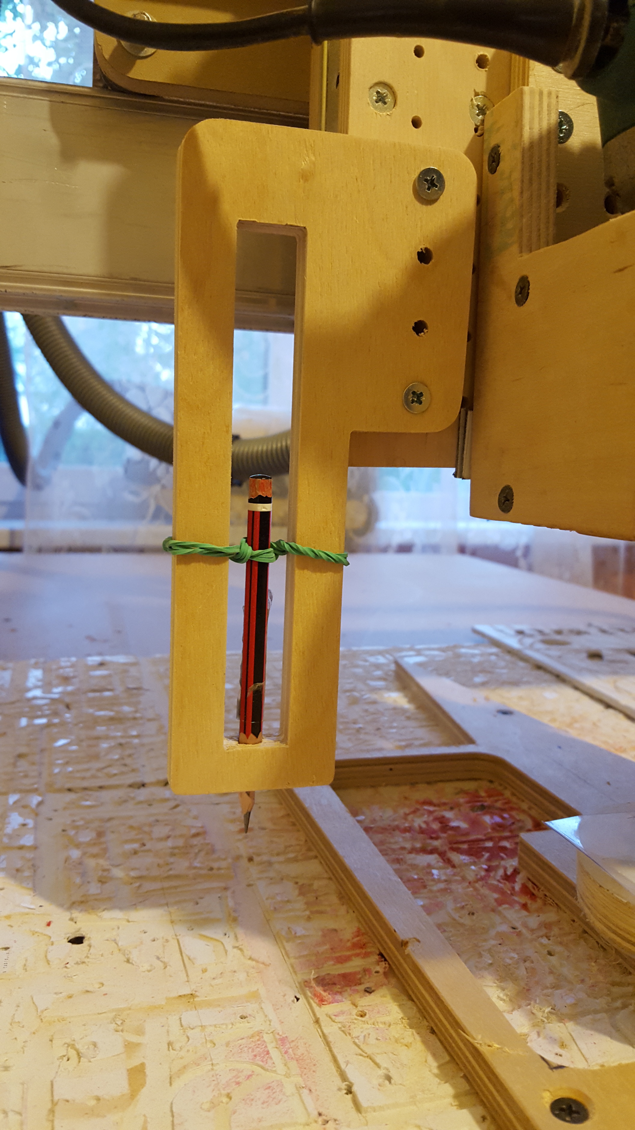

I have simpler solution without 3D printing

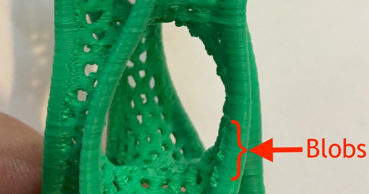

PM me your print settings, I may be able to help with stringing…the key is the retraction settings…since you have a bowden setup retraction usually needs to be longer.

this is TLDR but it helps me a lot in terms of figuring out how to minimize stringing and blobs in my prints

My retraction is probably different since my bowden tube is crazy long on my big beast of a printer…I actually get better results with 30mm/s for retraction speed. What slicer are you using? does it have a setting for coast and wipe? Coasting stops extruding the last tiny bit of a movement and wipe makes the extruder actually do a little stutter step to help reduce/eliminate stringing…
That is a crazy long retraction…if you start having print quality issues it is likely caused by pulling hot filament into the cold portion of the hotend and causing partial jams…
that is an older version of the slicer (I assume the one that was provided with the printer)…time to upgrade (it is free)…you will have more control over your settings.
increasing non-printing movement speed can also reduce stringing.
It depends on the extruder setup and how efficient it is…16 is ridiculous, 8 is probably too long…my bowden tube is much longer and if I use 8mm it will cause a jam. But, use what works for you.
