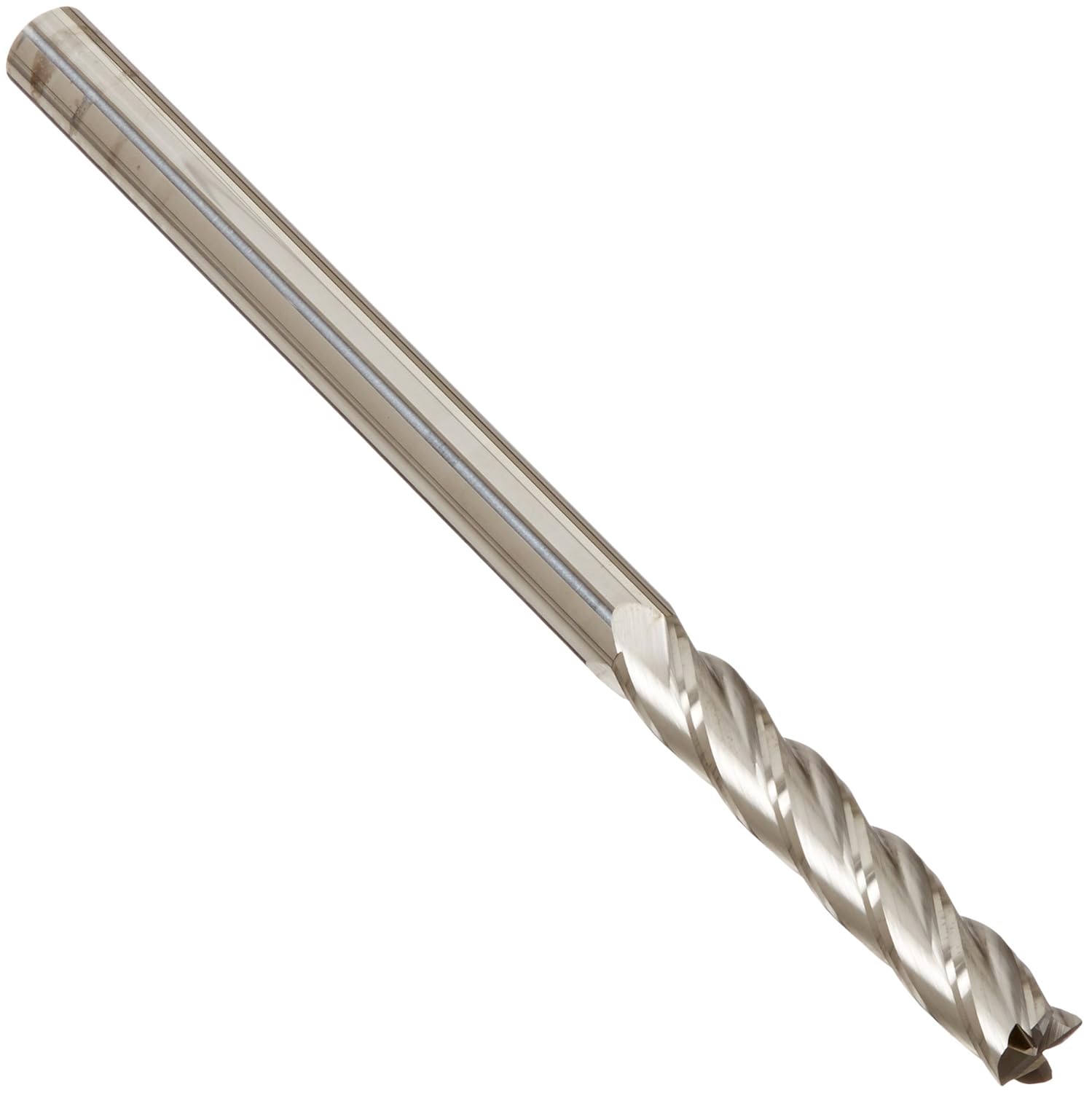

Hello everyone. Looking to make a cutting board this week in the shape of Pennsylvania. I’m very new to the CNC community and just wondering what’s the best bit to use to accomplish this task? Looking to use walnut probably with manual dewalt 611.
Any type wood bit could cut it, but you will need a long bit about 2 1/2" (wood, little for play, in the collet). The more Flutes the better cut but the higher cost. But if you plan on rounding over the edge then the less sanding if the cut is not so clean.
I would consider the way I do it (and others), make the plan in Easel for cutting the full 1 1/2" deep, when your done hit the “Simulate” button, if too many hours consider cutting 1/2" or so deep and finish the cut with band saw or jig saw, then use a router with a flush trim bit.

This poor guy. You will easily find a .25" bit long enough to cut this out. No flipping necessary. If your machine is particularly unstable, then instead of just cutting around the profile, make a pocket (a new outline, .4" outside of your current outline) and mill out this “pocket”. It gives the bit room to breathe and remove chips.
Put your tabs (that hold the piece in place when you cut through it) on the FLAT parts of the state for easier sanding.
ehh I just think using a tool like that you are asking for trouble I think in theory the x-carve could do it but your asking for trouble. plus it will take forever to cut your going to turn a 45 minute job into 3 hours trying to step down at .040" or less and then mill out pockets for chip evacuation
longest tool I have used in wood on the x-carve was a 1.25" tool cutting 1.125" material and once it gets down to around .5" your fighting the chip evacuation situation all the way down to final depth

1.55" Depth Pocket, .25" End Mill, .1" depth of cut, .4" pocket around the vector, 60" per minute = 43 minutes. 1 hour at 40 inches per minute.
.1" should be very reasonable for a stock machine.
