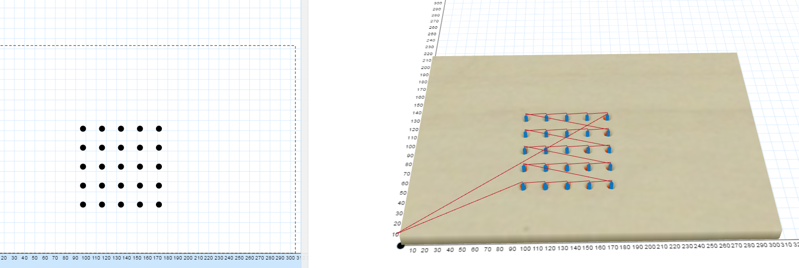

did some test (yep some stupid test just to try and share some results…)
i make a circle, replicate with replicator add
normal toolpath :
Beta toolpath:
BUT !!!
beta toolpath with all circle “combined”
i found the result funny between combined and not combined
BTW : the estimate time is reduced at 9min (with beta toolpath)
(15min with normal toolpath)
tha’ts great !
i found where we gain some time ! grats !
wow with a 45° rotation the toolpath (normal and beta) dont like it xD

Thanks for the feedback!
Given all cuts are equal (like in your grid of holes) we default to a left-right carve order. We’ll probably optimize this further at some point!
