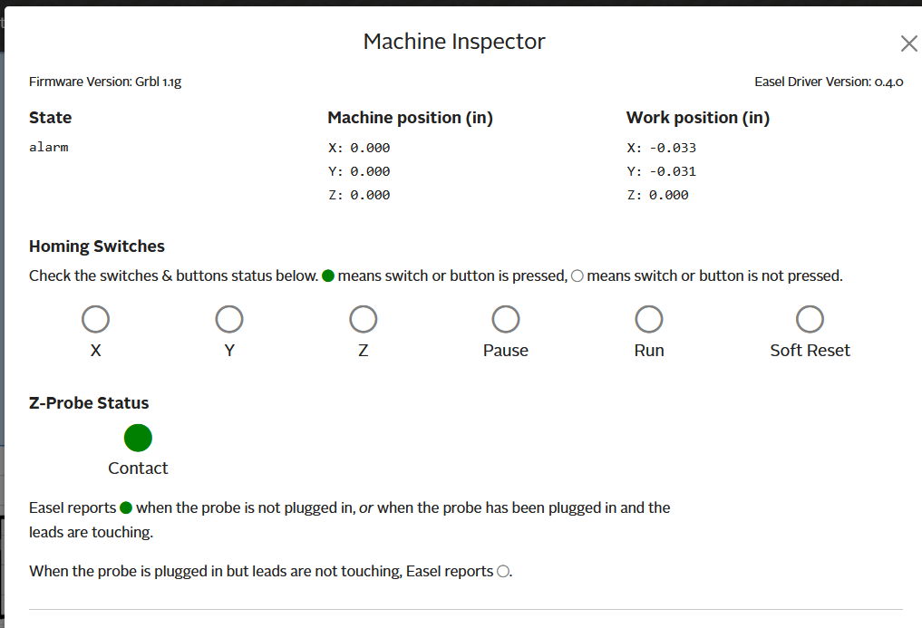

I am running an Inventables X-Carve 1000. For some reason the machine thinks the probe plate and magnet are touching. I have edited the machine and even created a new machine but the problem persists. Anyone know whats going on and how to fix this problem? I have closed Easel Pro and restarted Easel and also shutdown my laptop and restarted it with no effect. The pictures show that the probe is not touching the plate. In Machine Inspector with the probe plugged in it shows contact, when I unplug it the green dot turns off.

with the probe wires removed from the green connector at the back of the X-Controller are you still getting the green “contact” showing in machine inspector page?
If you are still getting this when there are is no probe connected at the back of the X-Controller, then the issue would be either software or a physical issue (could be the board or wiring) inside of the X-Controller.
Opening OpenBuilds Control to see if it shows “contact” in the troubleshooting tab over there would rule out the software as a potential IF the contact shows in both Easel and OpenBuilds.
Seth,
No wires attached: Machine Inspector probe shows Green
No wires attached: Open Builds shows Probe Triggered
looks like its time to open up the X-Controller and verify the wiring is good inside, from there I’d assume it’s the main board if the wiring is good…

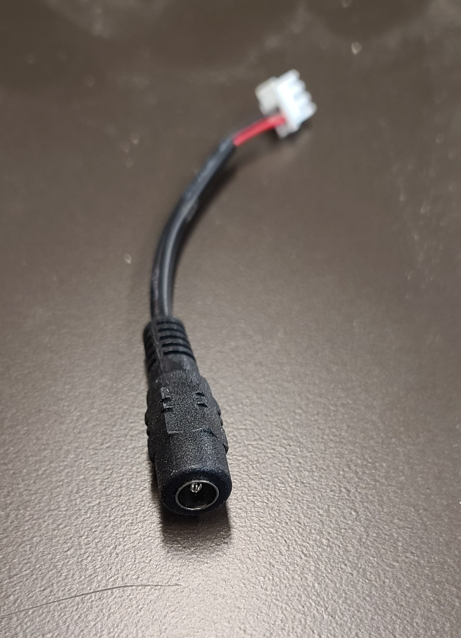

you will need a power source for the module, here is an adapter.
power on and off switch is ideal.

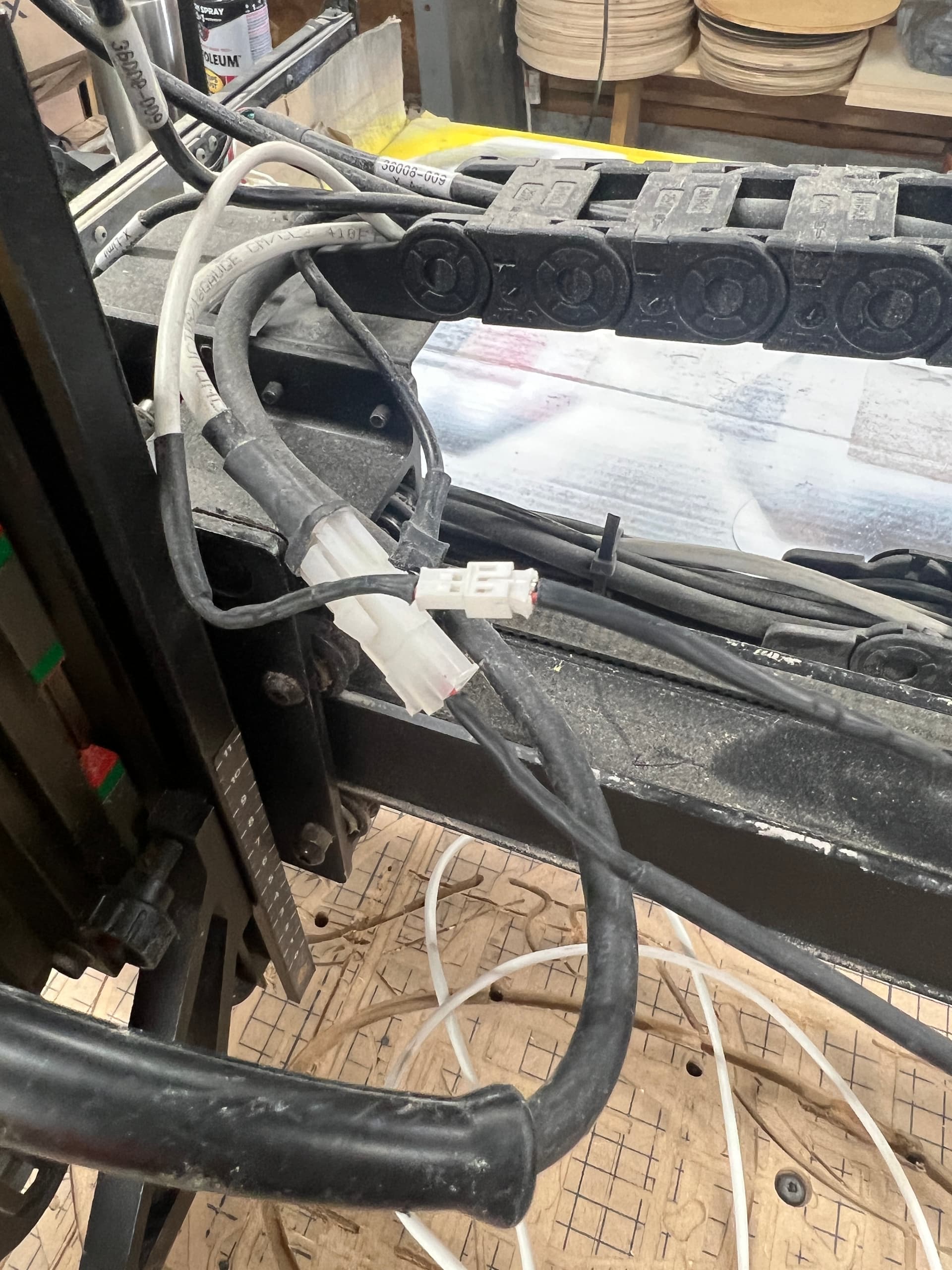

Here is my setup from JTech. In the picture showing the laser control on top of the x-controller one of those wires plugs into the back of the controller.

That’s the video I followed to install the laser!! :grin: :rofl: :upside_down_face: I watch a lot of Paw Paws video. He’s great at going slow and explaining what he is doing and why. But thank you for your input. But to me it’s looking more and more as a controller problem as Seth said. Going to open it up now and see if I can find any problems in it.
