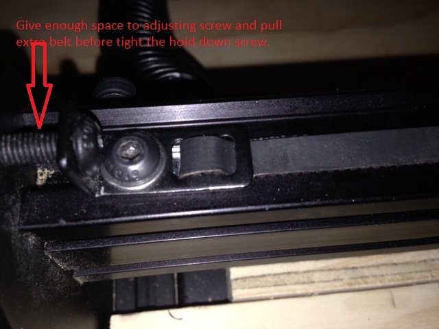

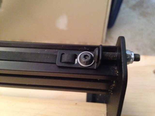

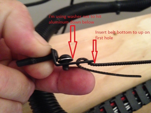

Belts - Belts. I 'm posting this pictures again in case someone want to do what I did. I have no belt problem what so ever.
If you find insert nut difficult to put, you can insert any metal piece same thickness. Target is jointing belts teeth together to hold each other.
