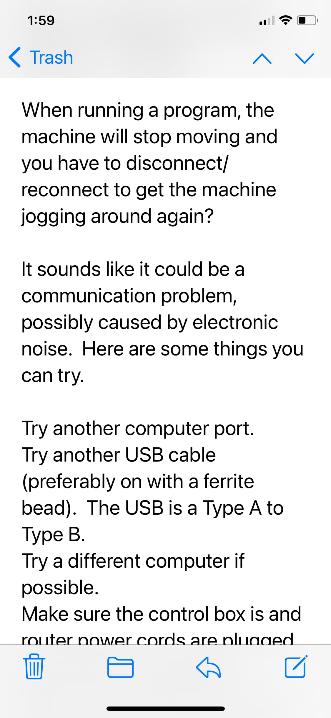

My CNC is a Millwright Carve King 2. So I emailed them to see what they suggested (see 3 attachments) basically the same thing I got from everyone one on Easels forum. I ordered a new longer shielded USB cable with ferrite beads. I have a powered USB port and I have a whole house surge protector. I also have 4- 20 amp circuits in my workshop everything is plugged into separate circuits. Because it’s an interment issue it’s gonna tuff to isolate once I get the new USB cable I’ll try everyone’s suggestion. Thanks for your help.
