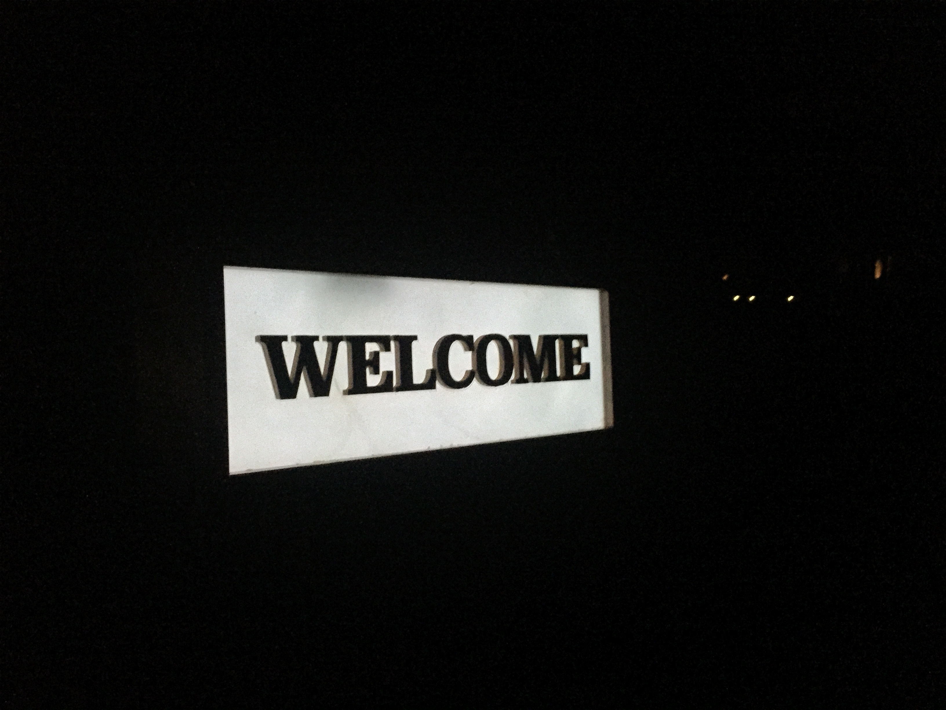

Here’s my latest project I’ve made with my X Carve. I made a box out of 1x4 select pine, used 1/4" red oak for the letters, superglued them onto the acrylic which I sprayed with a “frosted glass” spray.
I found a solar powered rope light at Harbor Freight so I cannibalized it, sticking the lights to the inside back of the box.
I cut the letters and the recess for the solar panel out on the X Carve.
And here’s the night shot. It’s difficult to use the flash and still get the impression the sign is ON, but if you don’t, the sign looks way brighter than it is. It’s basically a nice gentle glow.
