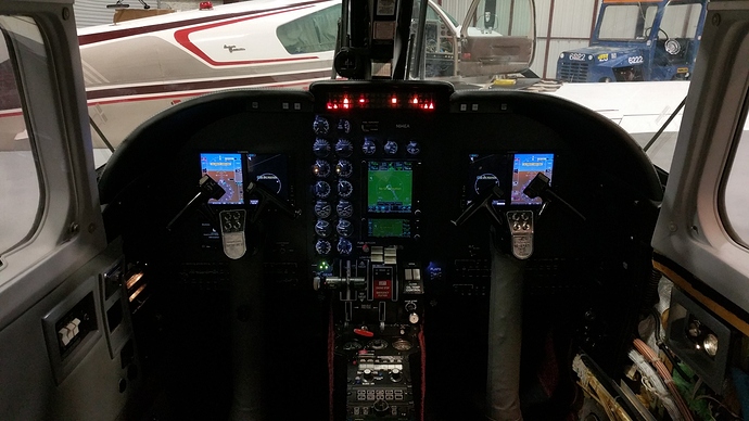

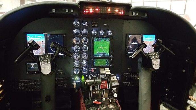

Thanks! I donā€™t really fell like Iā€™m making anything cool or exciting like most people here do. Itā€™s just a flat piece of metal with holes cut in it. Basically I fumbled my way through using a machine that was designed to do this soā€¦ But hey, it works! hahaā€¦
Until I can share the install of this panel, my first ever machined part, hereā€™s one I installed recently that an outside vendor made from my cad drawings. Itā€™s a 3 piece panel, .09 aluminum, and took 3 weeks to get. And then the customer requested some changes which took another 2 weeks on rush order. Soā€¦ the fact I built this one panel in less than a day is EXTREMELY valuable to this shop for turning aircraft on time (and now early)ā€¦ I need a bonus for coming up with the idea and then making it a reality! :joy:
On a side note, what you donā€™t see in these photos is the acrylic switching panel overlays on the ceiling. Iā€™m pretty excited to be making those now too! Hopefully soon iā€™ll be able to share a lot more stuff with you guys.
