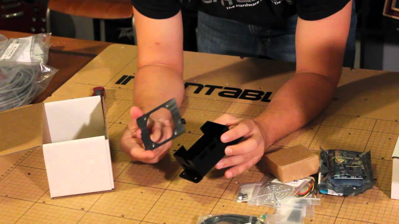

Hello everyone, I figured i would make a post to share my X-carve experiences and builds. I received the last box for my X-carve last week, so i created an unboxing video for it. I can’t wait to get it all assembled.

i watched your unboxing video the other day. one thing i dont recall seeing was the Z threaded rod (or acme rod) did i just miss that part of the video?
neat cart, should work great for space savings!
@BadWolf IT was one of the first things i pulled out of the third box. I don’t think i took it out of the plastic bag, but i do mention it.
ok cool i must have just missed it
