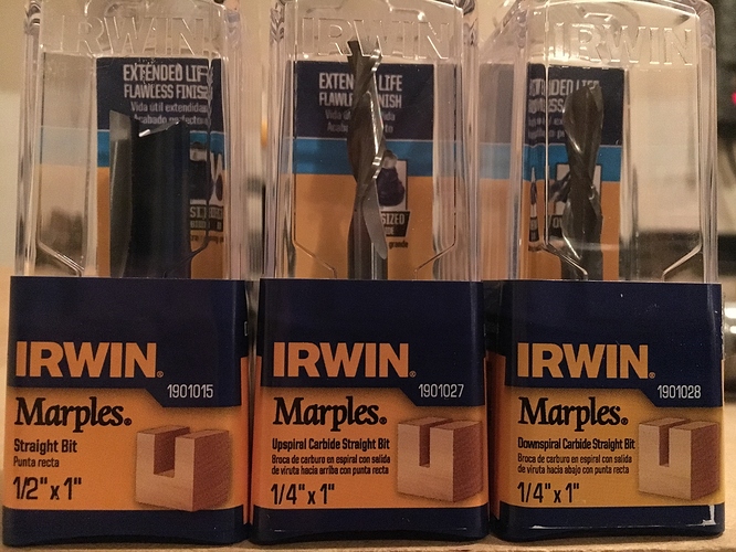

Anyone using stock router bits to do 3d-roughing?
I have a straight/mortising bit, but I’m worried about it’s ability to plunge.
Bosch 1/4-in Carbide-Tipped Straight Bit Model # 85221MC
Compared to these two… (less worried about these designs… the bottom teeth look like they will reach to the center.
IRWIN Marples 1/4-in Carbide-Tipped Straight Bit Model # 1901013 (19.98)
IRWIN Marples 1/4-in Carbide-Tipped Straight Bit Model # 1901025 (14.95)
Obviously the right design (19.95)
Bosch 1/4-in Carbide-Tipped Downcut Spiral Bit Model # 85903MC
If your bit has mortising listed as a use, it will plunge.
The bit in question
Not good.
yep… decided it was a non starter so i’ll vrab one of the others this afternoon. have ti wait through a birthday party for wifes friend’s 2yr old… I deserve a new end mill for that…
They work fine if you are using ramping to enter a cut
You will get much better results if you use a ball nose bit for the roughing pass.
