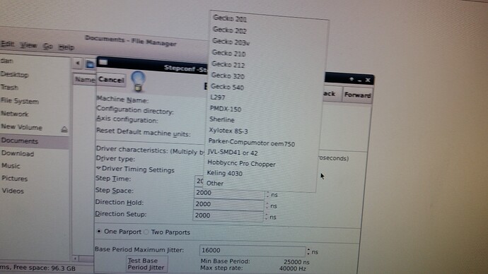

If anybody has an idea of initial values on this config screen it’s much appreciated. China spec sheet was sorely lacking :frowning:

Frustrating, though, I’ve still not been able to find any suggestions for the following:
STEP TIME
STEP SPACE
DIRECTION HOLD
DIRECTION SETUP
I have searched the internet high and low, and about all I’ve managed to find are people warning NOT TO BUY these awful drivers. They do seem to work, but I will probably swap them for a higher quality product very soon.

The settings attached are able to get me moving around and I’ve even done one pretend cut with the router off. I suspect that my hold voltages are wrong, since after cutting, the driver boards seemed fine; but when I accidentally left them on and idle for 20 minutes they were pretty hot. If anyone has any ideas I would love to hear them. I will post my settings for now.
