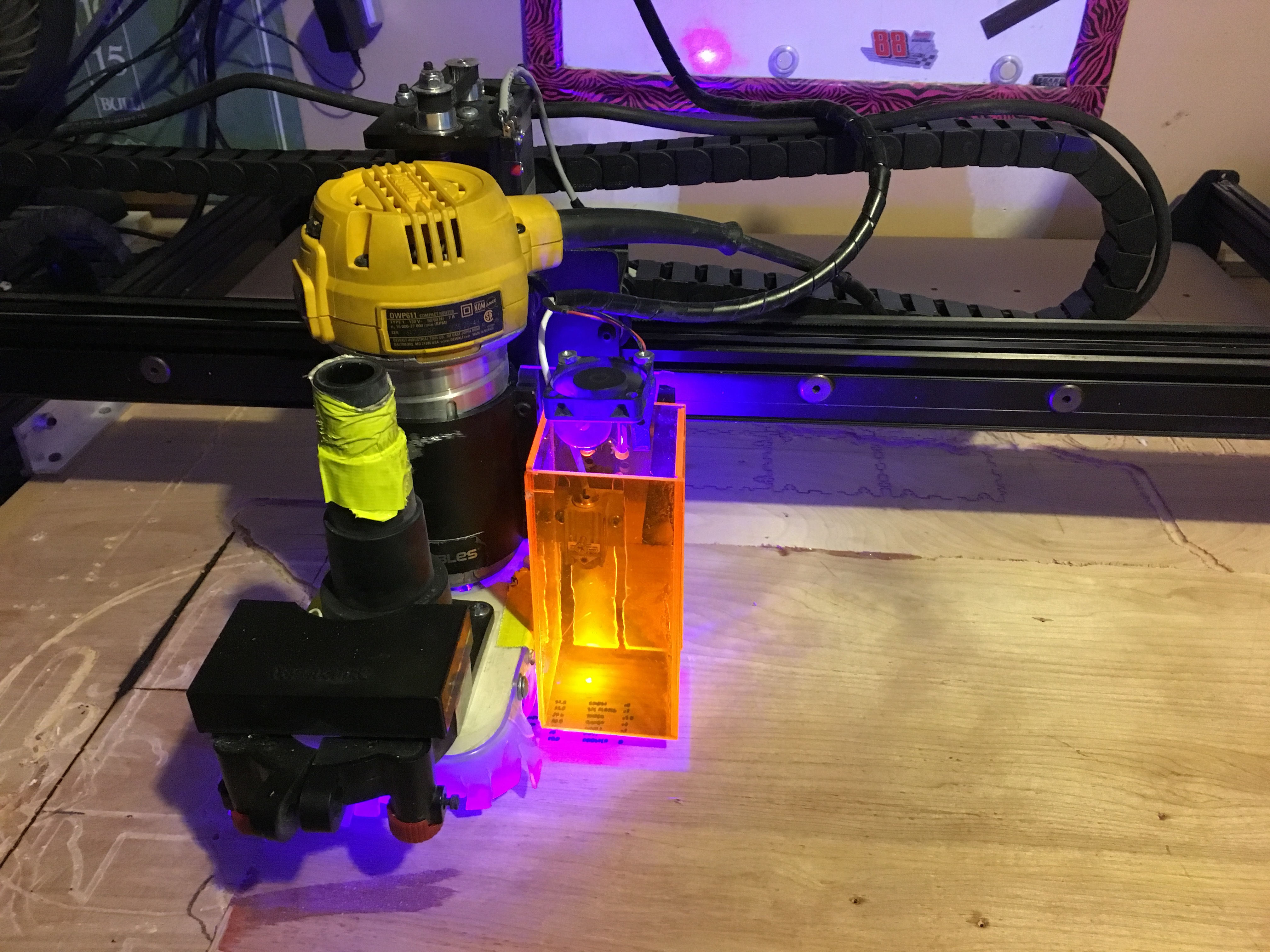

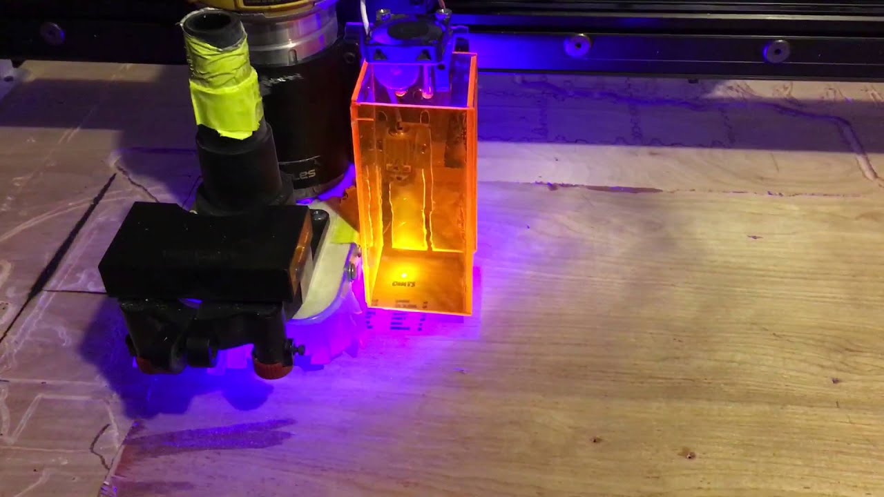

In my single car garage (rental home), I continue to fight with the homemade safety box I set up initially for the laser add-on. I finally laser cut out the panels to create a box. I did a bit of a chop job on the backside trying to set up the ability to raise and lower the box. I suspect if I had to do it again, I would also laser cut out the lines on the back.
Original set up:
Updated:
Youtube video:
I likely will play with this some more but I like it so far. I did see that as some one walks up to the garage, they can see under the bottom (1/4" approx. open) so I set up the rest of the orange acrylic to block that view.
Good job making that ingenious, simple addon to block the laser’s beam. :wink:
Thanks. I could have sworn that I had seen it elsewhere but could not find the same box through the various forums. I would have liked to give credit where credit is due but have been unable to find the source picture again. So for the individual who made the original simple box around the laser- thanks. I like it and definitely enjoy having the significantly reduced footprint around my set up.
