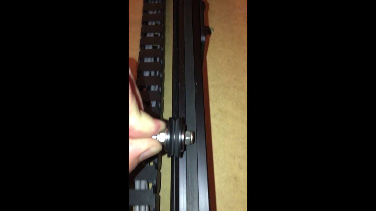

So I noticed something today while working on trying to figure out the problem. I went to swap out the new wheels to figure out what was bad and when I opened them to install the new fiber washers I found they are different.
The bottom is the original ones received in the kit, the top is one of the two replacements I received later. They seem to be much better the V seems to be sharp and clean. I put the two together and noticed the one on the bottom is a bit more oval than round, but just very slightly.
I also noted on original ones they do not roll smooth. The video does not really do justice in showing the full motion (Up/down and left/right movement) but you can see movement.
Anyway I have it at a point its much better than it was, I found one bearing that was not working and took the two worse wheels out. The two new ones keep the exact same resistance all the way across, the remaining six still vary. I just ended up leaving them loose so they don’t case sticking spots.
