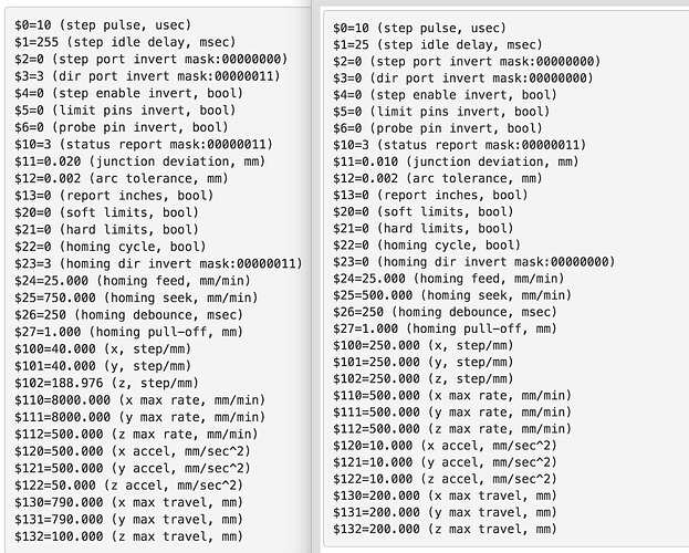

Alright, I will replace the arduino uno as I have a few laying around. I reloaded the arduino one last time and not it is moving “sluggish” on all axis like it “ramps up” to speed.
Now when Issued 10mm move it goes-
approx. 70mm on Y axis
approx. 250mm on X axis
Now off to replace the Arduino!
UPDATE:
Nope, still Ramps up and down and travels too far!
Ok. Guess it’s time to replace the gShield.
I checked the grbl parameters and some of them appear different? Is this something that would cause this?? How to reset those?
Thanks!
This is the same, it just shows the whole strings…
Yeah, that’s bad. If you loaded grbl version 0.9j from the Inventables fork then issue this command $RST=$
Should reset all grbl paramters to default.
If not 0.9j - I would load it.
