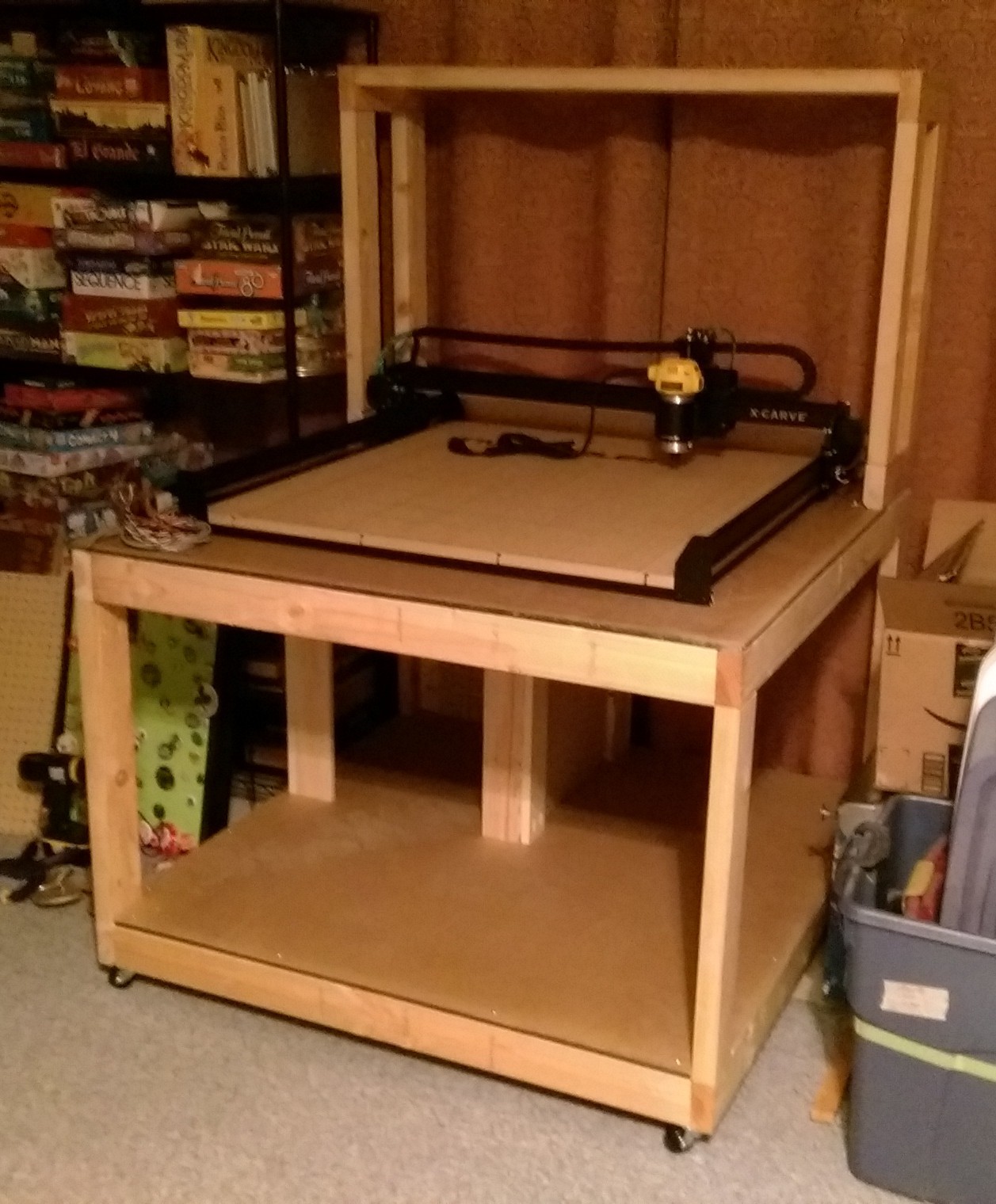

I’m in the midst of assembling my 1000mm X-Carve kit, and I’m beginning to design my bench and enclosure for it.
I’m considering the following…
  • Machine footprint
  • Machine height (including allowances for vac hose)
  • Doorway dimensions to room where I’ll be operating (so bench and enclosure can be moved in and out of the room)
  • Accessibility
  • Noise
https://amzn.to/3zJ1fdE
So far, it looks like I’m going to make a square bench… 48" Square x 32" tall.
The height is short, but it’s based on being able to flip it sideways to get it in/out of a doorway.
The 48" square dimension comes from half-sheet of plywood/OSB decking.
I’m going to have a top deck for the machine and a lower deck for the computer, power supply, controls, and shop vac.
The upper deck will have a 1/8" plastic windowed enclosure framed with 1"x3" pine boards, which will reduce the inner available footprint of the machine to about 46" square, which should still be plenty.
The enclosure will be hinged to allow access to the machine.
My questions are as follows…
  • Is a 46" square working footprint adequate for a 1000mm X-Carve?
  • What height should I use for my machine, if I have a Dewalt 611 spindle and am planning on using a dust collection hose attached to the carriage?
I’m considering maxing my hood out at 32" tall just to give myself maximum working room while still being able to fit it through the doorway (detached from the bench).
Any input or thoughts on this design will be appreciated.
Here’s a sketch…

Mine has the vertical (I’m guessing newer design), and it looks like if I have an inner work area of ~45" sqauare, it’s just enough to fit the machine… width-wise has less “wiggle room”, but it looks like it’s going to work. :smile:
Thanks for the information.
Here’s my progress, so far.
I’m lacking the hinged front part of the enclosure, and I still need to finish the shop-vac enclosure underneath… but I’m getting close.
Also needs plexi, but waiting to get list of dimensions from finished build.
I also plan on suspending the vac hose and spindle cord from the inside of the lid.

I’m getting close on my enclosure.
I finished up the Shop-vac box, which is lined on the inside with thick carpet (hopefully will dampen sound a bit).
I have plywood panels on much of the lid, and only the front and two large side openings on the lid will have clear panels installed.
I also have LED strip lighting to install in the cover to light the inside.
Hopefully, I’ll be able to fire everything up by the end of this coming weekend, if I hustle. :smile:
I’m getting closer to firing up the machine every day.
I got the enclosure finished on top… lights, plastic panels on the front and both sides (1/4" plywood sheet on other open panels).
I also got the vacuum enclosure done… lined with thick carpet, and the sound level is very tolerable. :smile:
Here is a current photo showing the lights (not as bright as the photo would have you believe, but they are adequate) and the vacuum cabinet door (latched door near the rear on the left side).
