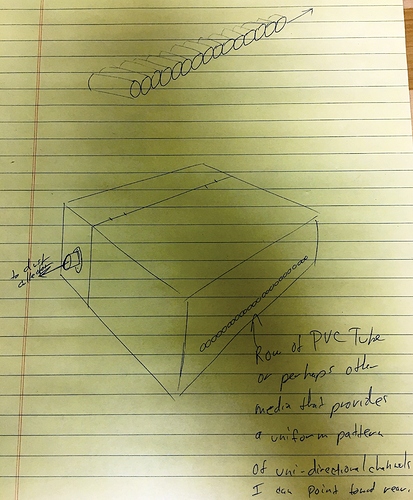

I’m planning on putting the dust collector connection on the rear of the box (on one side, so I can keep the enclosure up against the wall).
I’m planning on putting a series of holes (with flow-straightening tubes) along the front of the enclosure above the height of the waste board to generate a more uniform “sheet” of air flowing toward the back of the machine over the work surface. I’ll probably use 1/2" PVC or something similar, cut into ~4" lengths and glued together in a row, unless I can find some kind of hollow filter media or something else with inner channels I can use to straighten airflow the same way.

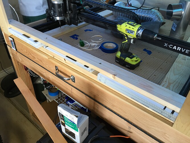

Okay… successful test, this weekend.
I got the following accomplished…
  • setup new 1HP dust collector (from Amazon for under $200
  • plumbed 4" hose and elbows to direct flow out of enclosure

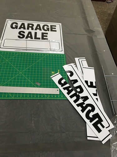

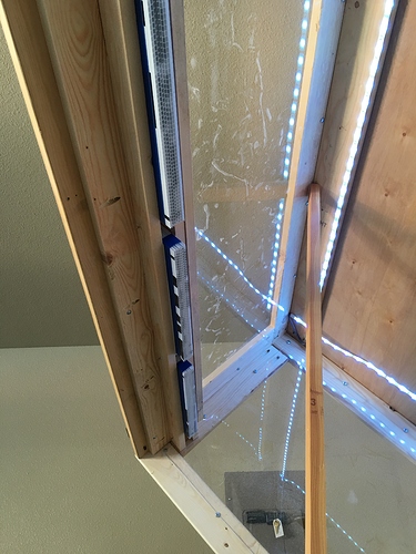

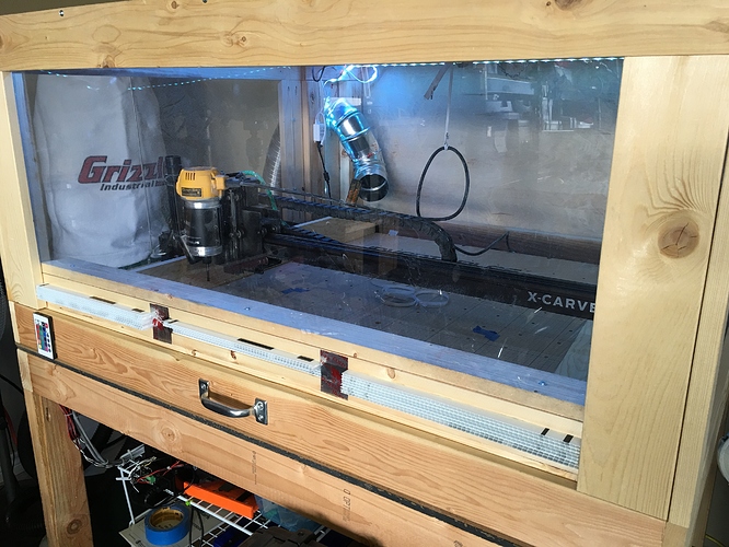

  • modified front of enclosure to include “laminar flow assembly” made from chopped up corrugated vinyl “garage sale” signs (4" wide strips stacked across the front just above wasteboard height)
  • first test piece cut with new system

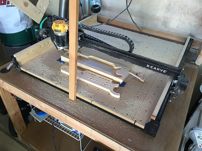

  • observed that fine dust was captured, larger chips were moved toward back of enclosure, Y belts stayed clear, and it ran at a reasonable volume having the desired effect
Here’s a link to my YouTube video showing the system in action…
Video of machine in action
Here are some photos showing the setup, configuration, and the outcome of using the system (feel free to ask, if you would like more specific details on any of this)…
