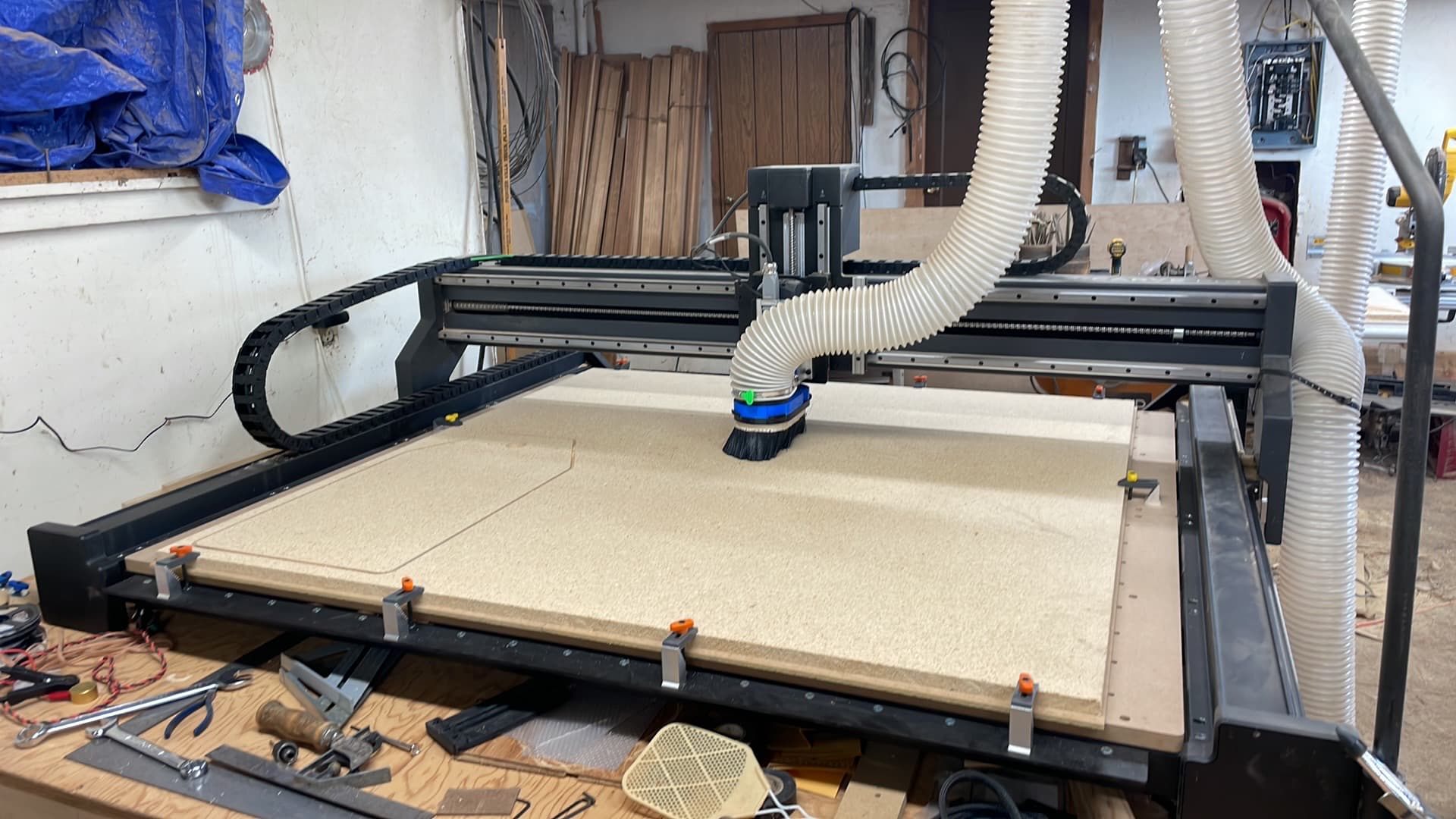

I was able to convert mine to a 4” with no problems. I will post a picture tonight when I get home and provide a link to the part I bought from rockler.
That would be great. Thanks.
Here’s some photos
You have to remove the top bracket for the original dust collection.
Also you need to use the offset adapter from rockler, if not you need to add spacers to the back of the dust shoe. The only problem with that it does not make the spindle in the center.
Link below
https://www.rockler.com/hose-adaptor
How does that affect the motors for the axis? Are you doing anything strange due to the extra weight and limited length? Or did you use an extended house to give you some movement?
Great question, I am not seeing anything funky but my dust collection comes from the top down so there’s no more additional weight or strain on it. I ditched the arm that was being used for the original set up.

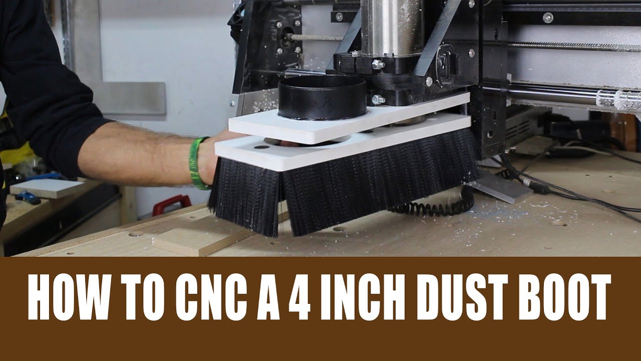

@BradleyBoysen are you happy with the performance of that set up? My dust collection also comes from up top. I was worried that reducing the diameter of the hose that drastically would kill the CFM. Was thinking about trying to find a way to make something like this to replace the existing shoe. https://www.rockler.com/dust-shoe-for-axiom-pro-cnc
Yes and no, I wish I did not have to reduce down but it’s not that bad. I really think I am going to design and new dust shoe and print it to keep the 4" dust hose. I feel that is where most of the problem is with this setup, they really funnel the air down at the bottom of the dust shoe. I would love to run some tests with it to see how much suction loss there is. I know I have a little coming from a 6" main duct to a 4" hose.
I am in the same boat. Let me know what you come up with. I don’t have a 3D printer but I was thinking I could make it with the Xcarve. I could mill out a copy of the adaptor plate that locks into the slide but modify the curve to hug a rigid 4" pipe instead of the 2" pipe its connected to. Then mill a shoe that looks similar to the one I linked to above that accepts the 4" pipe. Glue it up and it should replace the existing shoe entirely.
Something like this would be easy to craft that hooks to the dust bracket. I bought an additional liner rail bracket for just this purpose, lol. Just need to stop being lazy to design something.
