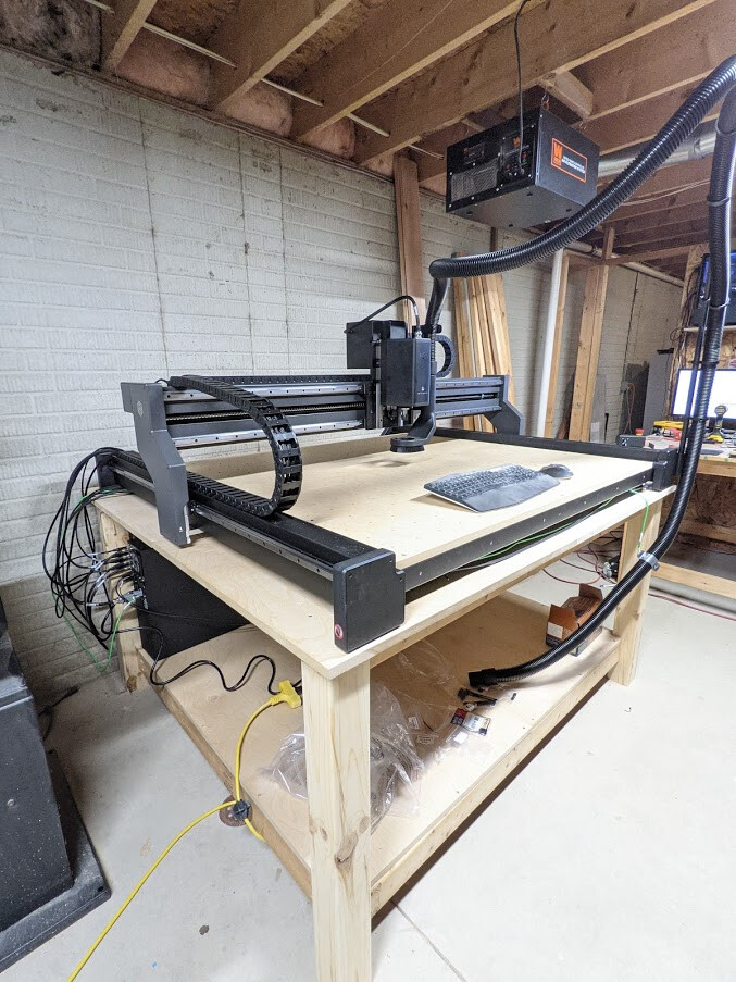

Overall I am happy with it. Everything is considerably more robust than the original X-Carve (as it should be).
Everything is packaged really well. Early shipments experienced some supply constraints, so clamps and the z-probe came in a separate package. It is my understanding that this will not be the case in the future. Supply constraints also meant that my unit shipped with the original spoil board, but I will be getting one with t-tracks in the future.
The tool kit felt a little cheaped out on, but I found myself using my own tool kit for a lot of things. I am going to keep the 17mm and 22mm open end wrenches at my workbench for the spindle, but everything else is going to be in my tool cabinet for the occasional PM.
Speaking of PM, there is a really nice detail where all lube points are marked clearly on the machine. Greasing the bearings shouldn’t be a problem as all grease points are easily accessible.
With the 25mm ball screws, unloaded movements are louder as expected. The machine has 4 homing switches, 1 for y1, 1 for y2, 1 for x, and 1 for z. The homing switches on y1 and y2 square the machine before you use it, which was a constant issue I had with the original X-Carve.
The surfacing bit that was included is an Amana 45525 1-1/8" carbide tipped board. It took about 27 minutes to surface the entire spoil board, but surfaces all the way to the front and to the back to allow tiling.
Having the spindle run off a VFD to where it turns on and off automatically with the carve is really nice. I don’t want to go back to using a router as a spindle.
I am adding curly cord wrap to the cables for the HMI. A USB and RJ45 run from the HMI to the control cabinet and I just want them to be kept neatly.
The control cabinet has threaded holes on the bottom, but does not have feet. I will be adding actual feet to the cabinet.
What size table and height did you build for it ?
What size table
@FrankGJuzna 67" wide x 60" deep x 33" tall. It is of note that Inventables recommends a 6’x6’ surface, but in order to do that it would take 4 sheets of plywood. I opted for a more optimized size and was able to get the surfaces out of 2 sheets.
Also, make sure there is ~8" from the back of the machine to the wall. The gantry has an offset in it and there is a motor plug that sticks out the back of the machine that would be smashed.

Anyway you can possibly give more specs on the table?
I just received my XCP today, and am assembling it on the floor until I do a table.
I am curious about your specific dimensions for your table (top 2 pieces WxL specifically)
@TCarter I can caution you anything, don’t assemble it on the floor. This thing weighs over 300 lbs.
Attached is a file for the workbench I built. In order to make it out of 2 sheets of plywood instead of 4 I split the tops into 4 sections instead of the 2 that are shown in the plans.
X-Carve Pro Workbench.pdf (103.7 KB)
I’ve noticed how heavy it is. lol.
Out of curiosity, which software did you use to design your workbench? with the cutouts/plans?
@TCarter I used Fusion 360 to design it and create drawings. I have a 3D model of the original X-Carve and could use it as reference to make sure it would work for my plans.
