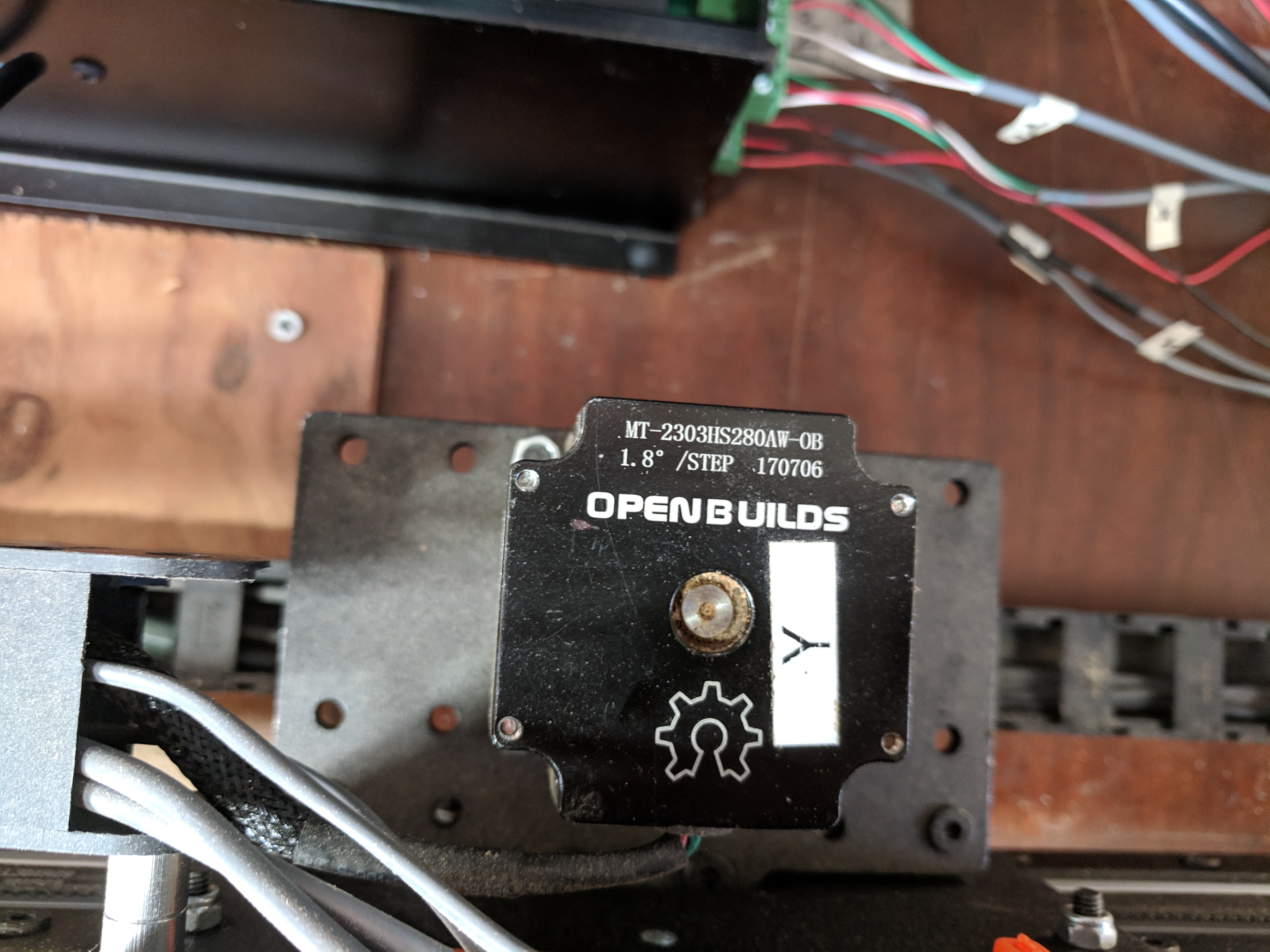

I connected an X-Controller to a CNC using NEMA 23 motors from Openbuilds (mt-2303hs280aw-ob) and when I go to set up the machine, each axis will move 1 step and stop.
Any idea what this could be about? I unplugged the limit switches to make sure I wasn’t getting a false positive and it still happened.
This whole machine worked with its earlier (terrible) controller, and I wired the motor wire colors correctly.
Some pictures of your motor wiring would help.
Also post the $$ output from grbl here.
Thanks - here are photos, pretty straightforward assuming these stepper motor wire colors are universal (white, green, etc.)

Don’t assume that. Depends on manufacturer and sometimes date of manufacture. Pretty easy to test the pairing, though.

With an unknown stepper the fastest way to identify the two wire pairs is to measure resistance with a multimeter.
A pair will show some resistance, the others will show no continuity.

Oh also, when I test the X wiring as an example, the Black and White wires show resistance between them, and the Red and Green do as well - does that tell me if this is wired the way the stepper motors in the instructions are wired?
Wiring should go black, white, red, green. One of your Y motors should have ONE pair flipped (switch red and green). If anything moves the wrong direction flip one pair.

Thanks so much - that worked. (Actually the wiring that worked in the right orientation is black, white, green red and then flipped for the Y2 motor).
