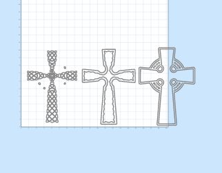

That file is a bit of a mess, if you are using it as you sent it to me it shouldn’t jump around if you are using only 1 bit on one pass. If you are breaking it apart and running three passes you need to lock your motors and use your homing switches so you can always have a home and a XY point.
Here is how I would run it, see the last two workpieces
