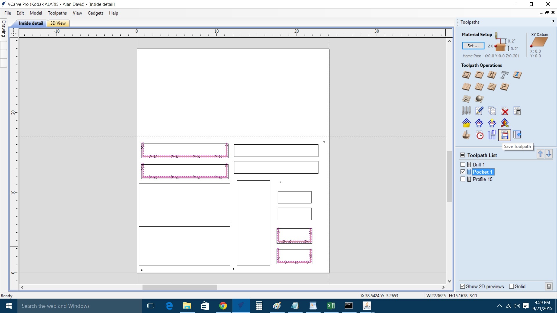

They go into these folder. Just see folder stracture in address bar.

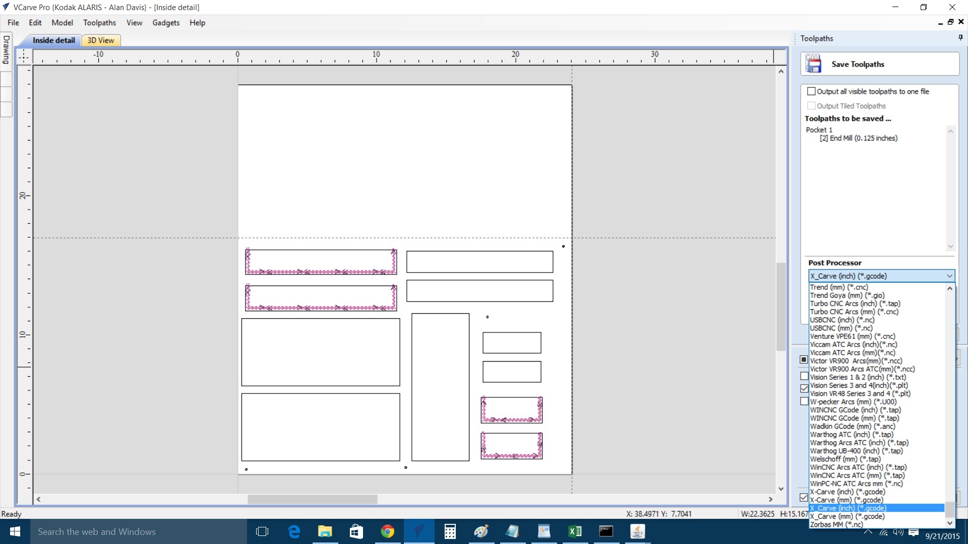

Then, you have to create Tool Path on Vcarve just like you see on the screen shot.
You’re gonna save your Tool path any good place you can find.
When you’re saving toolpath make sure you’re choosing Post processor you just copied into folder.
Now you have Tool Path saved. You can go UGS and do your homing/Z zero and browse your Tool path under File Mode, make sure everything looking good on Visualize screen, And click Send button and start running. Or sit down and watch.

No, go back start reading and checking those screen shots again. Those .pp files needs to be put into those folders. Those are not Vcarve drawing files. Those are Post Processor files Vcarve needs to read them when you’re generating Tool Path file from your Drawing. I put those screen shots to show you where those files must be.
Lets try this way;
  1. You’re putting those .pp files to that folder.
  2. You’re drawing anything on Vcarve.
  3. When you Save your drawing, that is not machinable file, just a drawing file.
  4. Just under 2D view on the left hand side of Vcarve, you’ll see like a window there is arrow pointing to the right, clicking to that.
  5. You will see another side window opens on the right side of screen.
  6. Choosing what kind of tool path you need, just say Cut. That is the first Icon. When you click it, you have options for Dept, Bit size, you’re generating tool path by clicking Calculate at the bottom.
  7. After calculation is finish, you have to save that tool path like you see on my window shot I sent you.
    Follow those screen shots.

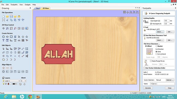

this photo from my first project, you can see not complete craving, maybe because not use the same bit size, 0.5 v bit ,0.5 mill bit , is it too big for carving small size , my cnc is 50*50 , m8 threaded rod , what is the best bit size i have to use.
this is my vcarve job. it assume the same result, but you can see not carve all the surface .
It looks like you made a lot of progress! Good job.
When you are carving small letters you may want to try a 60 degree or even a 30 degree vbit.
Dear Allen
you see that the cnc not carve all the surface, why that ?,also my threaded rod m8, can i use 0.5 inc end mill or 0.5 v cut.
