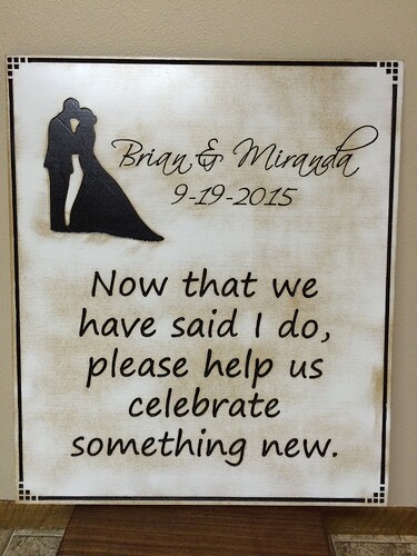

i use contact paper as a paint mask. works really well
heres one of my signs right after removing the mask, before final clear
Wow, that is very clean right after removing the mask. The few times I have done it the masking hasn’t cut as clean as I would like and ended up causing some issue. The contact paper you are using is just like shelf lining you would buy at a store like Walmart?
Yep its con-tact brand clear. I got it at home depot but im sure you can find it other places. Pretty cheap too. Like $9 for enough to do 30 signs like the one i posted
I think the key is to peel it off while the paint is still a little wet.
My process is to stain and clear the board, put on the mask and carve. Then clear the carved parts to seal the grain, then paint the carved parts and remove the mask. Once it drys i lightly sand the whole thing and put on some more clear
