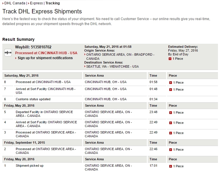

No way it will take 5 working days to Seattle from Cincinnati. Mine went from Ontario to Cincinnati, to DC, to very rural, one lane mountains of WV in 2 days total. Guessing you will see it no later than Wednesday because of the weekend. (Cincinnati to DC by airplane then dropped in the USPS)
