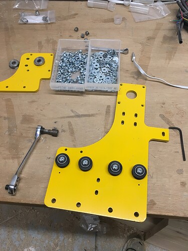

A few months ago i purchased the plates from @Phantomm to carry out the conversion over to a lead screw drive rather than the belts.
I’d had a number of issue with the belt setup over the years, from slipping pulleys to belts breaking. I’d changed from the GT2 belts to a GT3 which was an improvement however i still had belts failing and never managed to push the machine all that fast without issues. I moved house back in August and my X carve was packed up and then put in a corner which then turned out to have a leaking roof, i thought i’d fixed the issue but not before the MDF waste board was destroyed. So the machine has sat unloved for a few months while other things took a priority.
Following Christmas and i’ve finaly got some time i can spend on the machine. So i wanted to paint the plates first after this was done i could spread out all the parts
I just got the plates from @Phantomm as i was bringing them back in my suitcase when i was on holiday in Seattle. The rest of the parts i ordered from a number of UK suppliers and Inventables. I’m using all new V wheels, bearings and ecentric spacers as my machine is still on the old style ecentric nuts. This meant i could start putting together the plates before taking the machine apart.
Having the extra number of V wheels on each side seems so far to add significant rigidity however i won’t really be able to tell until its all together and cutting.
After fitting all the V wheels I went to install the limit switchs however i found it was very close to the hole for one wheel so i had to remove the wheel and refit using a small OD washer.

I moved on to fitting the nut block for the lead screw. The holes in the plate are slotted for adjustment however once the plate is fitted on the rail you can’t get to the bolt heads. So i put it together but not fully tighten and then removed it and locked the nut block in place.
it would be good to be able to adjust the placement which the block fitted. I may cut some groves to take 2 tee nuts so i can fix from the outside and adjust up and down. We will see.
Next up was the end plates on the Y axis rails. a little bit of care is needed hear as one end is tapped for the stepper motor and one end isn’t. They came labeled however i cleaned the text off before painting. Again the holes for the Y axis makerslide are slotted for adjustment.

Check your y nutblocks. Looks backwards.
Nuts on inside screws on outside.
If you are using hex screws then maybe they will fit. Just be sure to have enough space obviously. :grin:

I said Y. X looks fine. Y is backwards and will make fine tuning the alignment a small issue unless you have hex back there

I had a look at changing them over, however i can’t fit a spanner between the Y axis makerslide and the plate. I’m thinking of routing a small recessed slot behind the hole to take a tee nut. The recess would stop the nut from being able to spin whilst allowing up and down movement for adjustment.

It’s your standard mechanical alignment procedure. Move to the extremes and check for binding.
Also the Spanner does fit from the side. And there are low profile spanners that you can buy.
