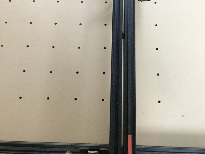

I have the larger 1000 x 1000 machine. I did my board a little different. I cut the board to 1000 x 1000 but could only use 1\2 due to the wheel clearance. I ordered an extra square tube and cut it to size so I have a total of 4 rails not three under the board. I drilled my holes, counter sunk the screws and attached the pre-assembly nuts to the bottom of the board. Then slid the nuts into the rails making sure I had nuts for the corner supports in their proper places.It was not easy and like I said ended up with only 1\2" board and not the 3/4" board. Then by moving the rails by hand I was able to make straight lines that were square to the machine on the board and then drilled all my hold down t-nut locations. Went really fast. only about 1/2 to mark and drill the holes. I did not need all 144 holes since the machine does not reach into all areas and I spaced my lines out to be 2" I think. The recess on the back side of the board is no big things since it will not be seen so why waste time. I am going to mark my lines with a really small tip and only about .01 or .1 deep, run some pain in there and I will be done. Do not have a laser yet. Good luck.
Wheel clearance shouldnā€™t be a problem with 18mm MDF (3/4") unless the board is cut too big.
Correct size for the spoil board is 940mm x 998mm.

Well the svg file was too much for my browser so I created my own Easel template for drilling holes. I only drilled an 11x11 grid at the standard 70mm spacing. I will drill the other 22 holes by hand. But the grid looks nice and Iā€™m busy fabricating a housing for my JTech laser / fan mount to engrave the grid. Hereā€™s some pics of the drilled grid. Iā€™ll share out the Easel file soon.
Ok hereā€™s the Easel file: Waste Board Drillinā€™
Set the bit size to 0.245 inch if you are using a 1/4" drill bit. This fools Easel into carving the holes in one pass. Otherwise it will complain that the bit is too big. I thought about adding counter sink holes but I was getting sick of drawing and not milling. Iā€™ll countersink the holes by hand.
Thanks for sharing your file. I had a friend look at the svg and dxf files. When SketchUp exported them, it converted the circles to individual lines. I wasnā€™t able to get Easel to load the svg but we are running on an air card so I thought that might be the issue. Canā€™t wait until my X-Carve arrives!
Just so everyone knows this is not an identical pattern to the factory waste board. The holes should be about 30mm to the right of the origin (0,0). I chose to use the X-carve to drill the holes so they are shifted compared to the official CAD drawings. For my use I didnā€™t care about where the clamps will go. If you want a 1-1 factory waste board you will need to drill the perimeter holes by hand.
