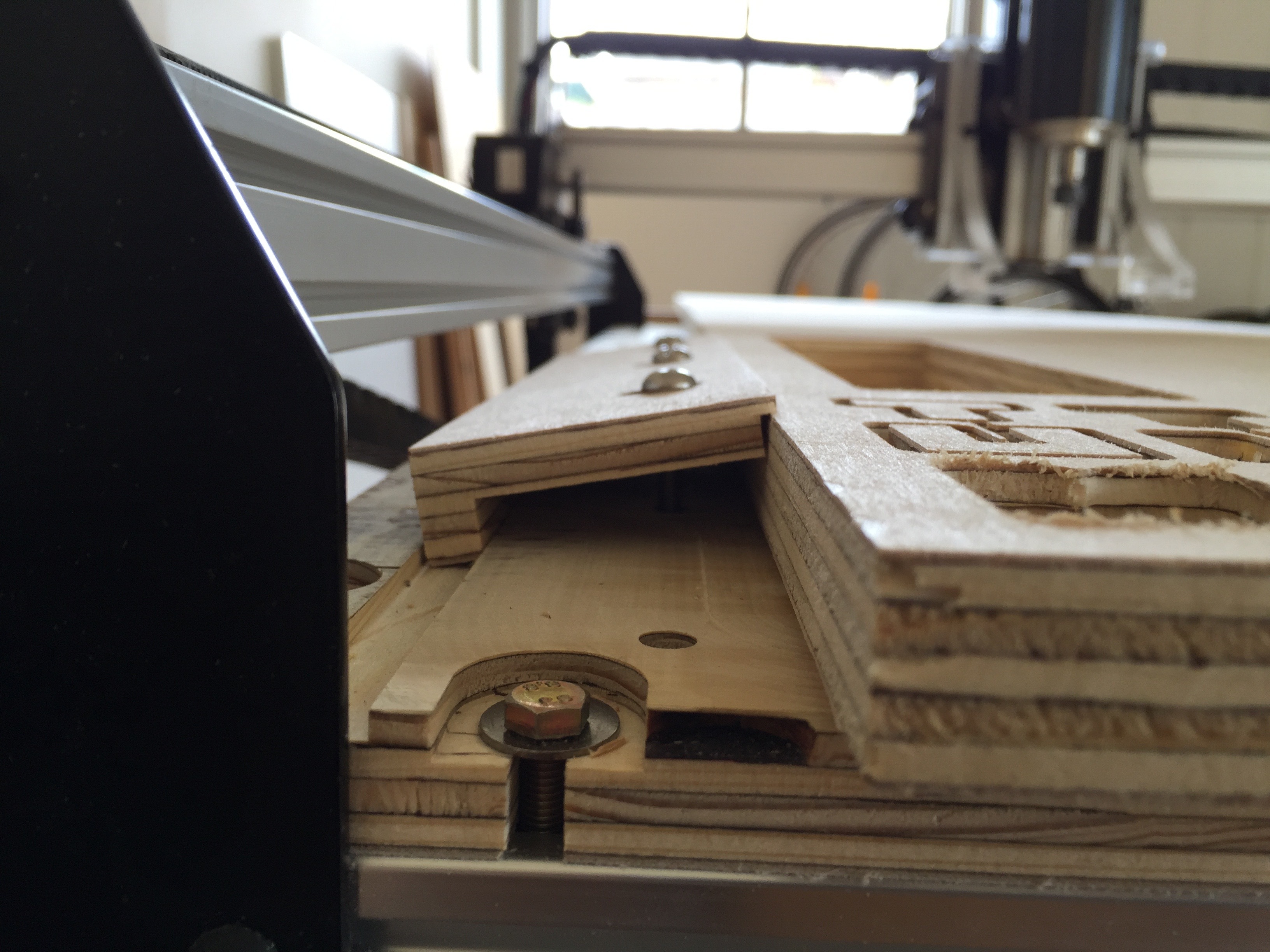

The stock fits in under the little lip all the way on the right of the clamp. The lip is very flat so the tool can get very close to the edge of the work piece.
The lip is flat and narrow so it won’t be very strong. I’m hoping that by making the clamps long the pressure will be distributed along the length of the lip and so make up for any weakness.
Two of these clamps on the left of the machine should be able to hold long work pieces down securely and parallel to the y axis. A couple of similar clamps on the right should do the same for the other side.

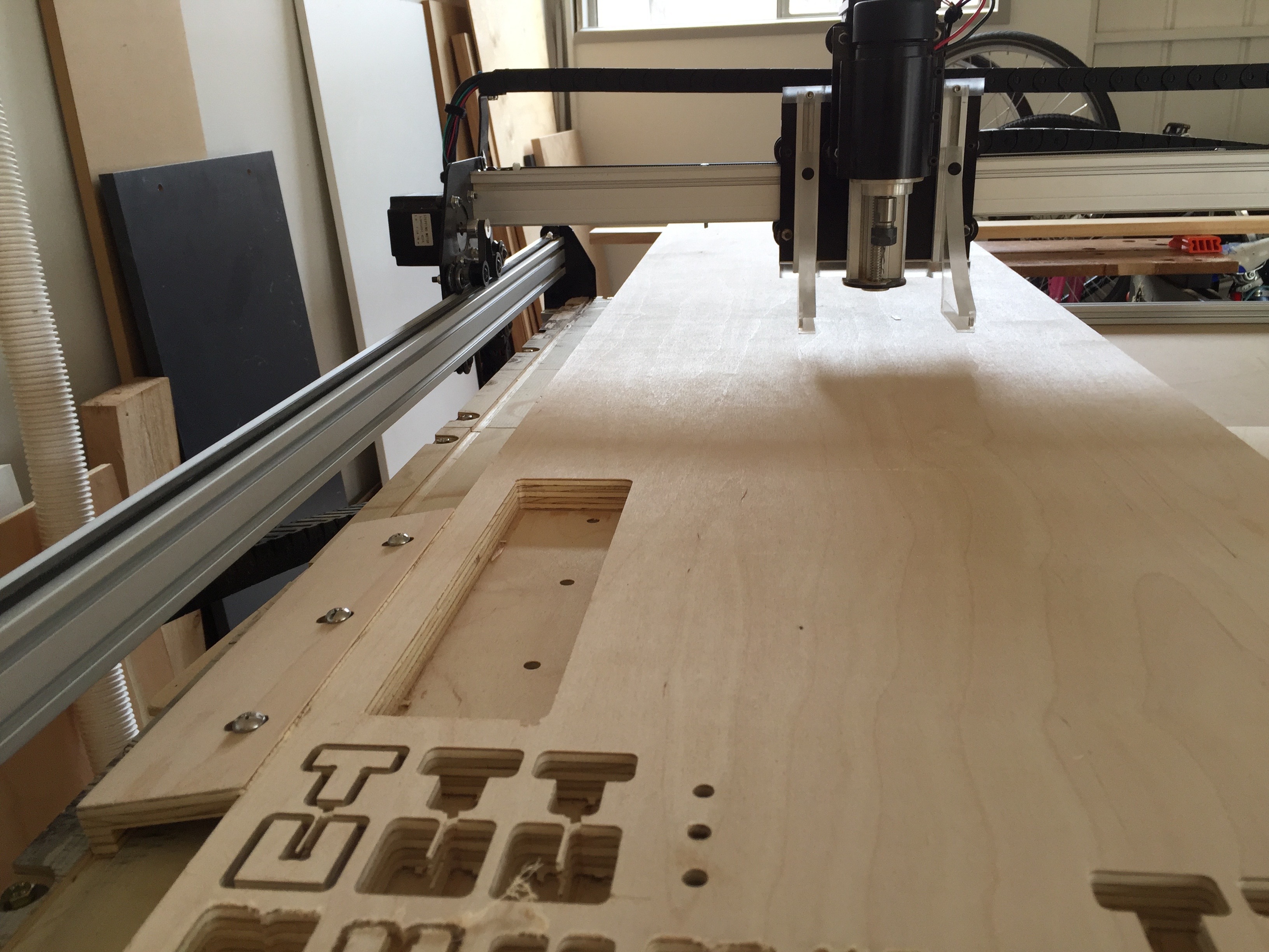

It’s easy to forget we can do these things with CNC technology. So I finished the baseboard today:
I think I will be leaving the two clamps on the left in place permanently, they are super convenient.
Here are a couple more work-holding options:
In this one you can see the longer clamp on the background. I will need to cut a couple more, maybe of different lengths tho avoid that horror at the front of the machine.
When I first cut the two-hole clamp I didn’t set the z down far enough so the holes weren’t cut the whole way through. I mounted it on the machine, up against the left to ensure it’s parallel to Y, then I went into fusion and set up a cut to only cut out the holes. I set the zero point in the Fusion 360 operation to be one of the high corners in the clamp and then set the zero on the X-carve to be the same point.
