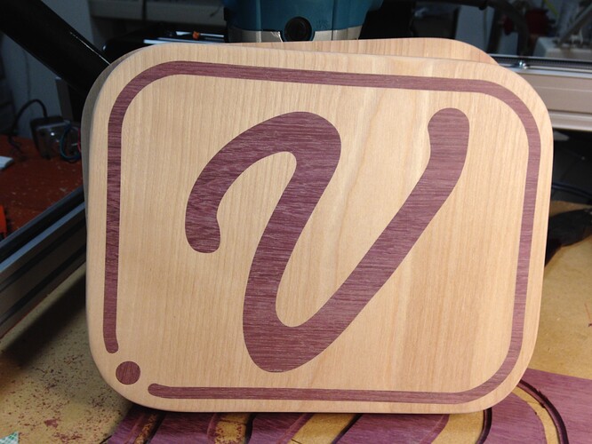

Nice job! The colorful knives really set off the wood colors and inlay
i should have something this week. Had some personal things come up.
Very Nice! Is that Blood wood? very pretty.
That’s actually “cherry” from Inventables. Bought it a long time ago and just had a chance to use it. Pretty sure it’s not really cherry though (sorry inventables - just sayin’ - most iridescent “cherry” I’ve ever seen).
This is purple heart :smile:
Before bee’s wax:
After bee’s wax:
I have real cherry on maple somewhere but I can’t find a pic right now.
Great fun pulling the project together and making it come alive. Hopefully the family will be equally impressed.
-Tom
That “Cherry” looks a lot like Padauk.
