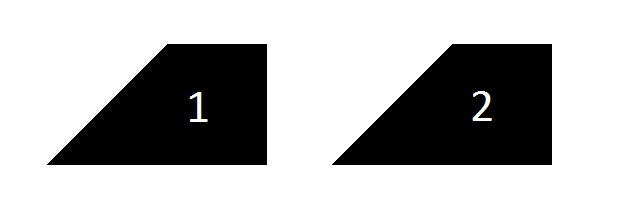

The problem I’m having is that I believe the pressure up from underneath is rocking the router back slightly by twisting the X-gantry. I’ve clamped the two pieces of makerslide together with vertical bolting which seems to have greatly reduced the twist when I try to move it by hand, but it did not correct the issue with the shoe. Removing the brush but leaving all other hardware in place returned the performance immediately to the way it was before. Replacing the brush with foam likewise resulted in a return to excellent pocket-bottom finish. The only thing I can figure is that the bristles on the brush exert sufficient upthrust pressure when they reverse directions that it forces the z axis to twist on the gantry a bit. I’ve checked all my connections and v-wheels, of course.
Actually there is way to eliminate that. But I couldn’t do it. Brush material must be 45 degree angle looking down. I saw that somewhere on the net. This time doesn’t affect the head assembly. It opens very easy when push down. If anyone can find the way to make 45degree angle pocket for brush, that is the solution, because it’s pushing up on first down.
That does make a lot of sense, it would certainly let the brush flex without transmitting nearly as much force back up into the Z-axis slide… Hmm, now I just need to come up with a way to implement that!
Mill 2 rings with a 45 deg slope on the edge.
Flip one upside down.
Now the space between them is a 45 deg channel
Glue both rings to your base.
Does that make sense?
