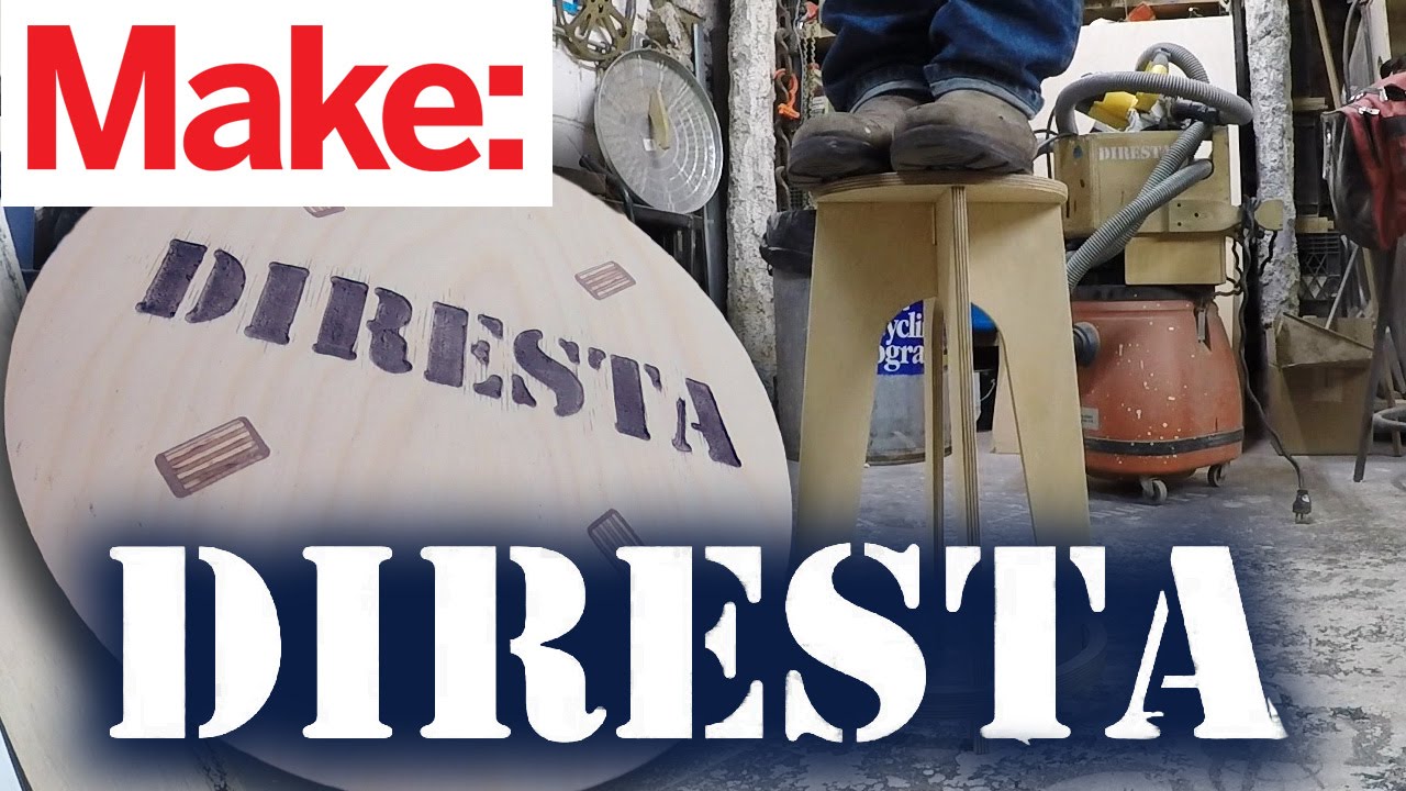

When I was leaving I half jokingly half seriously said something like "Jimmy do you think you could make a stool that was made all from a single piece? He sketched a few things and then BAM the next day he sent me a link to this video. He also published the files so everyone else could make one too.
Then he posted the whole video on Make:
The whole experience was pretty awesome. Jimmy has a great attitude and is super patient and willing to experiment. It was pretty humbling to see one of the most prolific makers in the world start small and build on his successes rather than trying to build a rocket on the first try.

Sistering the stretchers was brilliant! As was the wedges and wood filling the keyholes. Very inspiring. What about a contest for stuff you can make entirely in one 31" square? Hmmm…:sunglasses:

If anyone hearts and then remakes this stool and posts their remake by July 1st they will get a $100 gift card to Inventables.

@JosephCompton it’s really up to you. Both approaches qualify as a remake. You can do an exact replica or you can make some modifications to make it your own. You need to post it as a remake project at the bottom of the original project. Screen shot below of where to add it on the project page.

Very nice @DonaldLeblanc! Quick turn-around. The homage to Jimmy is a nice touch. Here’s his version to save you from going over to the Projects page (not mine):
On my Limbert tabouret version, I’m not going to have the keys protrude through the top of the seat. They’ll be 1/2" deep and still register the location and add strength.
@JosephCompton, I’ll make the prototype out of ply, but once it’s good to go, I’ll be able to make it out of QSWO like I do everything else for around the house!
I’m interested in seeing what you come up with. I didn’t want the tabs sticking through either, so I was going to use a thicker piece for the top. I was actually thinking of making a smaller square design that would actually be more useful to my kids, but I’m not sure how much time I’m actually going to be able to put into this.
What if you just didn’t go all the way through with the rectangular holes. Imagine if they were pockets that the tabs slid into but the top of the stool was flush.
