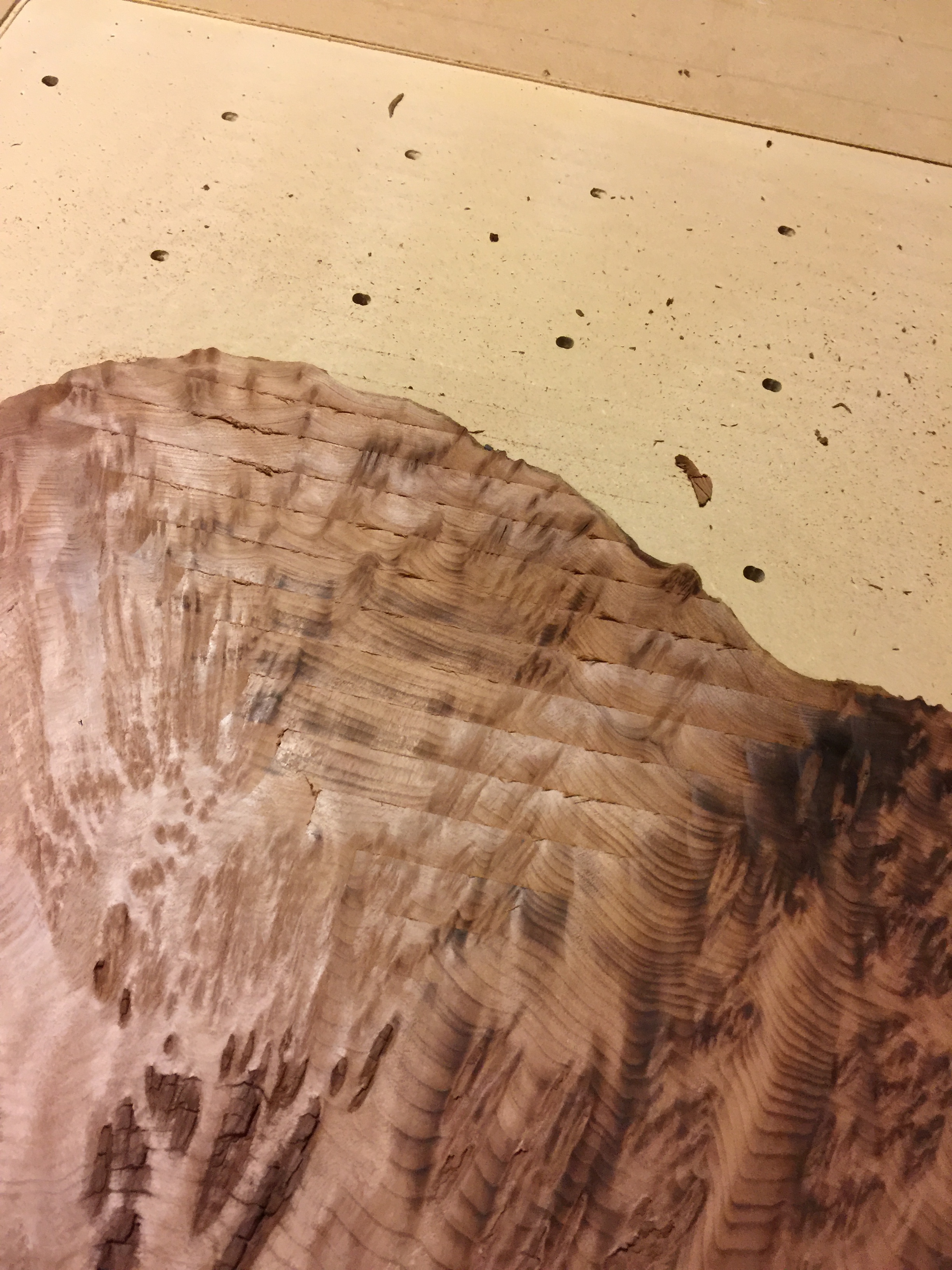

On my new custom 1000mm x 700 mm xcarve conversion I have an issue where consecutive cuts climb in height the farther you get from the center of the stock in both Y directions and it occurs for any length of material.
Y+
Y-
I have supports on the Y rails.
I think that can be caused if your spindle isn’t perpendicular to the waste board, AKA “Tram”.
The problem is if it was that it would cut deeper on one end and shallower on the other. In this case the depth is about equal front to back and with each successive pass both ends climb an equal amount.
The pictures are opposite ends of the same board from the same planing operation the top of the first picture and bottom of the last picture are the high spots. Each successive pass is lower than the previous pass.

If the z axis was not parallel with the wasteboard I would expect that it would cut consistently deeper on, say the -y axis across the entirety of the piece as shown in the right sketch . That is not what is happening here. As the cutter gets closer to either end of the y axis it is cutting shallower as shown in the left sketch.
To me this indicated the y axis was sagging th the middle so I added a support under each y rail shimmed to be just snug to the bottom of the rail. This did not change the resulting cuts and so here I am.
The board in the picture above is 22” long and this pattern only occurs in the las five inches on each end.
Oh and the z axis is not changing that I can see throughout the planing operation.

Actually the support was installed after I noticed the issue. I paused the job and made the supports then installed them and resumed the job. No change.
The orange is what I am seeing except just at the last few passes. Others have suggested cutter is not parallel to the surface. Okay I will look at that, except I would expect that one side of the cutter would cutt deeper than the opposite side and this would be true for the entire orange area. I am not seeing that.

Nope. Again if the router was tipped forward it would cut deeper in the -y all across the surface as it moved in the x. That is not what its doing. The cut is flat and climbs with each successive pass.
Just with my fingernail. Ridges get higher moving out from the Center.
