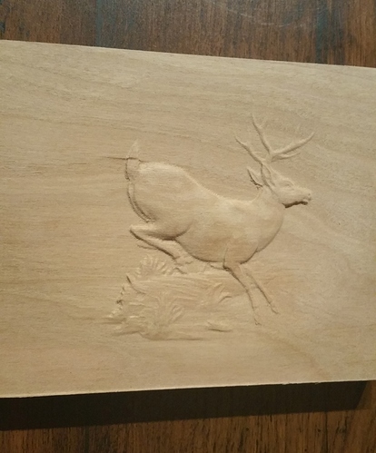

2 Relief carvings, each 5" x 4". Cut in cherry with a 1/8" endmill roughing cut at 75 inches per minute followed by a finishing pass with a 1/16" ballnose at 65 inches per minute. The bear was cutout with the same 1/8’ endmill. There is no sanding/cleanup done yet…there are a couple of bits of fuzz to remove.
I like the bear! Very nice. Are they from STL files?
Yes, picked them up on ebay.
would love to do stuff like this one day. is this V-Carve?
I used V-Carve, imported the STL file, scaled it to the size I wanted and generated a roughing and a detailed toolpath. Very straightforward process.

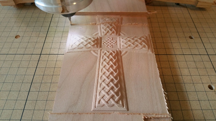

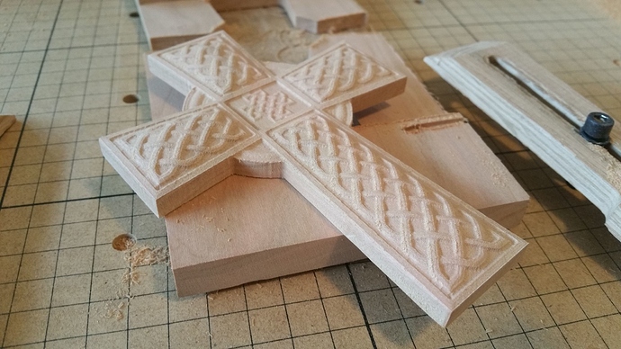

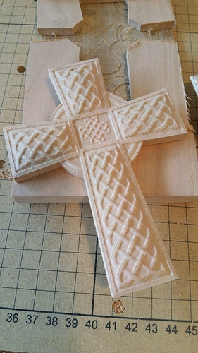

Cutting this now…Found one I liked on google and attempted to copy it in V-Carve. Used a 1/8" bit for the roughing pass and and a 1/16" ballnose for the detail pass. Cut in 1/2" cherry just under 2 hours to cut. The Cross is approximately 4" x 5".
Very nice! I am interested to hear your process of converting from a Google find to a carvable file in Vcarve. It is difficult to tell from the picture, but it looks like the top surface may have a convex curve, which is not something I know how to do in Vcarve.
Basically, I eyeballed it and recreated it from scratch.
The shape under the weave does have a curved surface. I created a rectangle, edited the nodes to have the rectangle smaller on one end.
