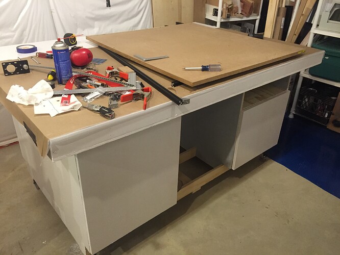

Equipment mounted and ready for connections.
A mess of wires! But it works!
Random build pictures:

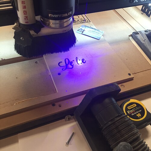

Laser is mounted and working without the ON/OFF feature.
Mount:
Easel File
The four laser holes are size for M3 bolts. The two bolts attached to the spindle mount are tapped for M4.
Some quick sample output:
