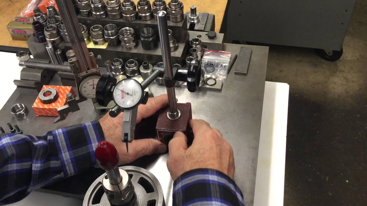

The Musclechuck states that runout is in the order of .000005". I used a .0001 Best Test indicator and the needle never moved. I’m happy with the accuracy.

Interesting. Never heard of these before. Can you measure the runout on a 1/8 bit?
Ignore the above. I just read this.
EDIT:
Here’s a video showing how to minimize the Musclechuck’s runout by “clocking” it so that its own runout works against the router’s runout.
