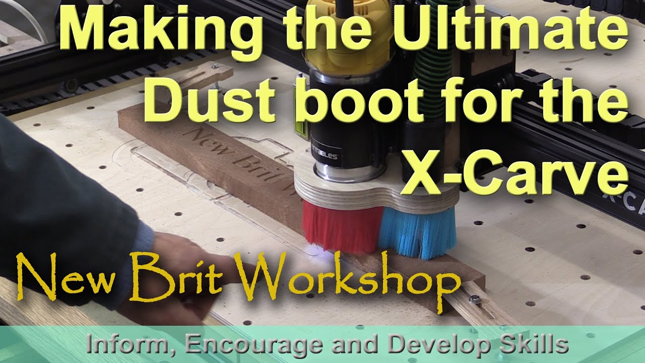

I know this has been approached in many ways but here is my take on it.
My “Ultimate” Dust Boot is not attached to the Z Axis and so does not get any backwards pressure from its contact with the work piece. I used the X-Carve to make most of the parts (using VCarve Pro). The drawings and VCarve Pro files are available free of charge if you PM your email address to me via YouTube.
Here is the link to the video:
Here are the various files but please note that you should make a test piece for the wooden part of the boot itself to ensure it fits your CNC and the router passes through okay. I had to make a minor adjustment to mine by shaving 2mm off the left hand edge because it hit one of the nuts on the gantry.

No surprise, it’s one of the best-developed fixed bases I’ve seen so far! Only thing I can think of that might make it better would be a spot for a small transparent window so you can see the bit. Would increase the size, though… It’s a darn good design as-is.

This is pretty much what I have in mind. I am going to have to rework my x-axis limit switches, however.
I’m also planning on making a dual-lobed boot that accomodates two vacuum hoses, since I have a large dust collector and would like to get more airflow at the cutter. Of course, the tradeoff is the loss of a small amount of x-axis capacity …
You need to consider the support for the hoses as the X Makerslide is taking a lot of weight already. Is there any way that you can keep it to a single hose even if it means a slightly larger hole on the right?
I’ve been considering using a ceiling-mounted piece of bungee to support my dust collector hose once I get the new set-up put together, myself. Just adjust the length until the end is just barely floating on the shoe, and not applying any significant weight, with the bungee taking up most of it to the ceiling…
