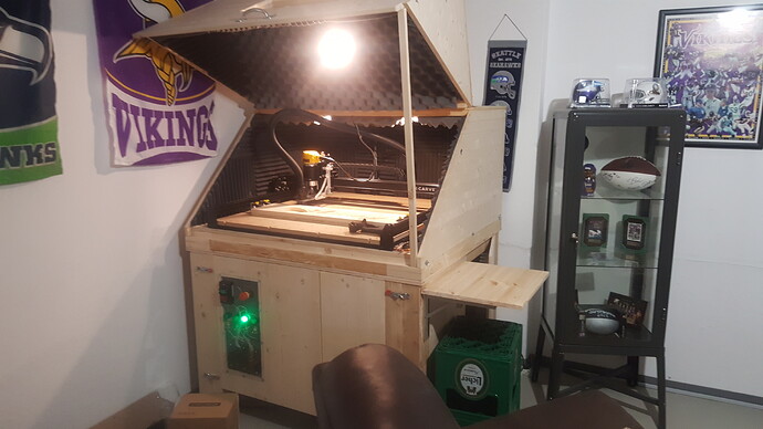

The top front section flips up, I’ve included a pic of it with the hatch open. My dust extraction system is working like a dream, I’ve been carving solidly for about 4 days now, and I can’t see any dust on the foam at all. I highly recommend that dust extraction setup Inventables is selling.
I meant what if you need to get to the back of the machine. Does the whole top come off for working on areas not in the front where you have that door. Or if you have it so you can slide the machine out that would work too.
Yeah, I can just unplug the cables and slide it out.

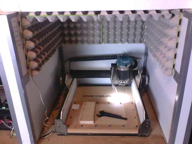

I have had the x-carve about a year, but due to health not really had a chance to use it. I recently made the enclosure and thought I would share it here as my take on this seems a little different.
The x-carve is in a room on an old desk. Noise and dust were main factors in this design, also a desire to do things simply and cheaply.
The enclosure is made from common 3" thick styrene blocks cut with a home made hot wire cutter, held together with wood kebab sticks and glue. The styrene blocks were covered with corflute sheet held on by glue and sewing pins, finally all corners were taped with duct tape. The window is 8mm thick glass (glass sliding door from an old sideboard). I put egg cartons in the top half to defuse sound (I thought it may bounce around inside the box).
I picked up every thing free (one mans junk…). I just paid for the glue, duct tape. kebab sticks and sewing pins.
Keeping things simple, I decided to mount corflute to the rails with valcro tape, this allows movement if there is contact and also easy removal for cleaning.
The motor and belt pulley dust covers are x-carve component packaging attached to the plate by a bulldog clip, lol, simple but effective.
The entire enclosure if very light and can be picked up to access the machine for maintenance and upgrades. Next upgrades are air cooling and a mount for the dial indicator (I want to get the bed a bit more level).
do you notice the difference with the egg boxes? Its something i thought about but haven’t done.
It is quiet, but I am unsure how much of that is due to the egg cartons, or the 3" styrene box.
