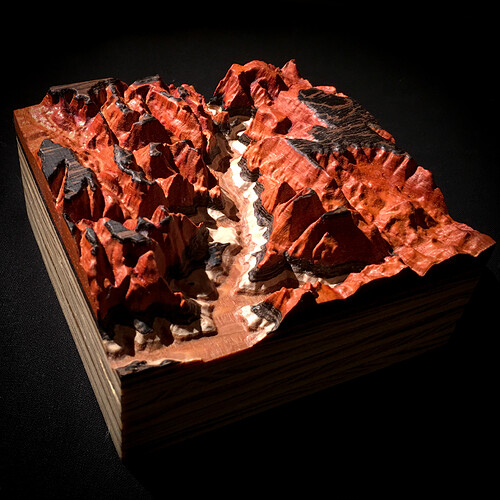

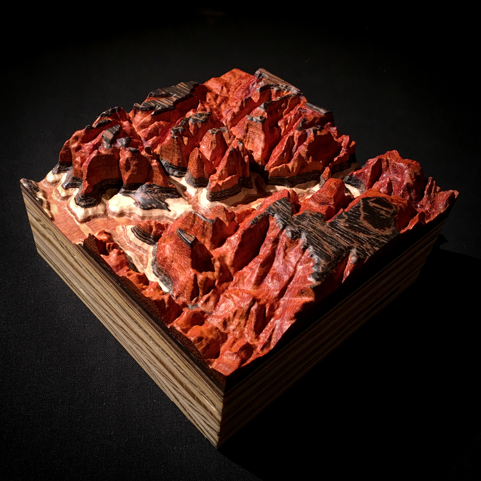

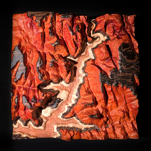

Zion National Park
Zion National Park in wenge, padauk, maple, and leopard wood on plywood substrata.

Thanks! It originated from lidar data and I generated tool paths off of that with some conversions. Cut on X-carve, of course.

fill bottom of river with some blue resin?
also… pretty sweet. whats overall dimensions?
How thick was each wood layer?

You know I tried to do that on a previous piece by injecting epoxy into the river but it ended up bleeding a little bit up the wood grain past where I wanted the water so it wasn’t as clean as I would have liked. I am going to do some experiments on some scrap stock before I attempt again.
The layers range from 1/8" to 1/2".
This one is only a 5" x 5" x 2.25" miniature prototype. I am trying to get the hang of my feeds and speeds on the new Dewalt spindle before I start cutting into expensive stock at 2 to 4 times the scale.
You can also try carving a disposable piece, cast the river, then remove and place into the finished product.

What of you used a piece of blue corian as the base piece so the lowest levels would be water blue?
