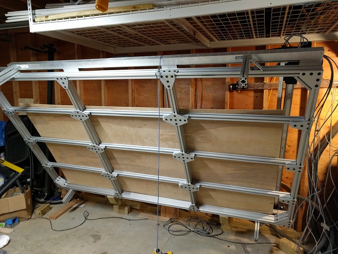

It all started with dear friend of mine offering me for free 6 x 6 feet long 1.5 inch by 3 inch extrusions.
After the trouble if him having to ship it with UPS it was for me point of no return.
Once I received them I was able to figure out that they come from amazing gold mine 80/20inc Their prices are very reasonable and I belie the can ship extrusions up to 108 inches long using standard UPS rates in us.
Next thank god to black Friday inventables coupons I was able to purchase long extrusions. I purchased two 1.8m and 1m rails for Y axis and two 1.8m for X rail.
Next issue I faced was connecting 1.8m and 1m rails to create long 2.8m piece. While base of my build is using 15 series extrusions (1.5inch), x carve extrusions are 20 series (20mm) I knew I can’t use any type of standard plates (I was wrong about it but bit more about that later).
I came across of something designed for Shapeoko, Makerfoot I figured I can use it to support my rails and create solid mending point for my long rails. I ended up cutting both pieces into 4 sections, 3 equal size and one bit longer one to support the joint of makerslides.
With that done next step was experimenting with various ways of connecting 80/20 extrusions. I purchased few pieces and while all of them worked just fine most of them was just way overdoing it and adding just adding to much cost. I finally settled on using 4 corner 45 degree supports you see on pictures and bunch of flat plates you see on the bottom.
For cross bars that will hold most of the weight of waste board(s) I just purchased 10 pieces of their 72 inch 1.5 inch extrusions and trimmed each to 34 inch long. I used all the left overs including one long sections to create about 2.5 inch long spacers to lift the beams to desired 3 inches leveled with tall sections.
That is where I’m at now.
Next step I’m planning to hinge side of the unit to be able to fold it on garage wall. The plan is to use square pipe that my wife promised to weld for me and remote controlled 880lb winch I scored for 109$ from harbor freight.
I’m also waiting for inventables to ship x controller before I start cannibalize my 1000mm unit for parts.

You can’t see much progress here but new shipment of 50 screws arrived and I could finally bolt it all together.
To my shocked this thing is squared up to 1/16 of an inch right after bolting it together. I was expecting to have to adjust things around, I had to do nothing.
I also tapped the maker slides and installed plates, funny how much easier it is once you do it second time. Took me probably 20 minutes for all 4 plates.
I think next step will be some clan up and start to tear down x carve for donor parts.

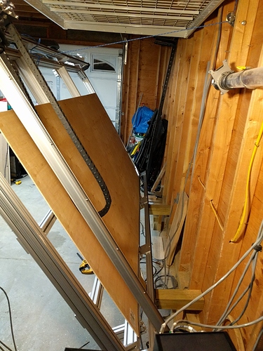

Got the folding mechanism done now. This took tons of work as I had to move up the shelves in garage for enough clearance. Was about to start wiring but I was unable to buy 70 feet of wire in HD, the only thing you could get in NY this weekend was ice melt lol.

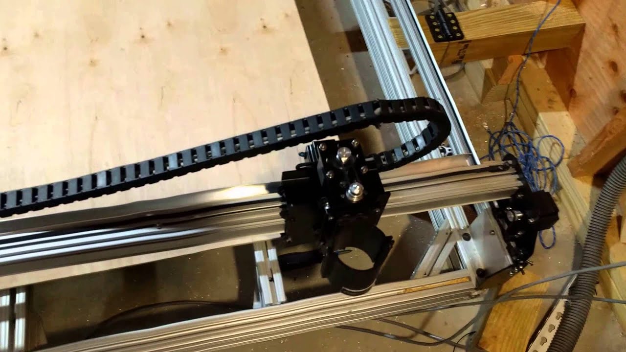

  • X axis drag chain was sagging way to much and it was obvious it will snag on work surface at some point. I decided to put to use tinny extrusions I had sitting around. Turned out well but I can see myself doing it better down the line.

I changed my mind on X chain support, while black extrusions looked cool it was just bending and vibrating. I just grabbed home depot L shape alu stock, it was not expensive and its perfect for it.
I also installed almost 3 meters of 30mm chain and supported it with much larger L bracket also from HD.
Wiring was so much more fun than my initial X carve build. 30 mm chain links open so you can just lay down the wires without dealing with sneaking it trough. Terminals I installed on all the plates made this also very easy and took me about 5 minutes per motor total. What I did mess up is my calculations of wire needed and sadly 50 feet of wire I got was not enough, had to order another 25 and should arrive by end of the week. For now I just spliced some old wire for testing purpose.

I’m still tweaking things with the lift and wall folding but it works very well so far, I just need to cut the steel rope and figure out the distances so the winch stops when fully folded and does not try to rip things apart.
So far it served me very well for all the work under the machine since like I said lifting thing thing by hands is not an option alone anymore.
Sadly I will have to raise the shelves I got over the machines again but I was half expecting it anyways.
Good news is I came up with setup that will not require any welding and is way more gentle with 4x4 wood than it would be will steel square pipe.
Small video from my testing how chains will work. Sorry for quality but youtube camera shaking correction overdone things just a bit.

I have not but I looked at them a lot. My idea was to have motors drag another bar to support wiring and dust hose without applying additional weight on X.
My understanding is that they are very well made and will work well but no made for precision. More for doors and such.
