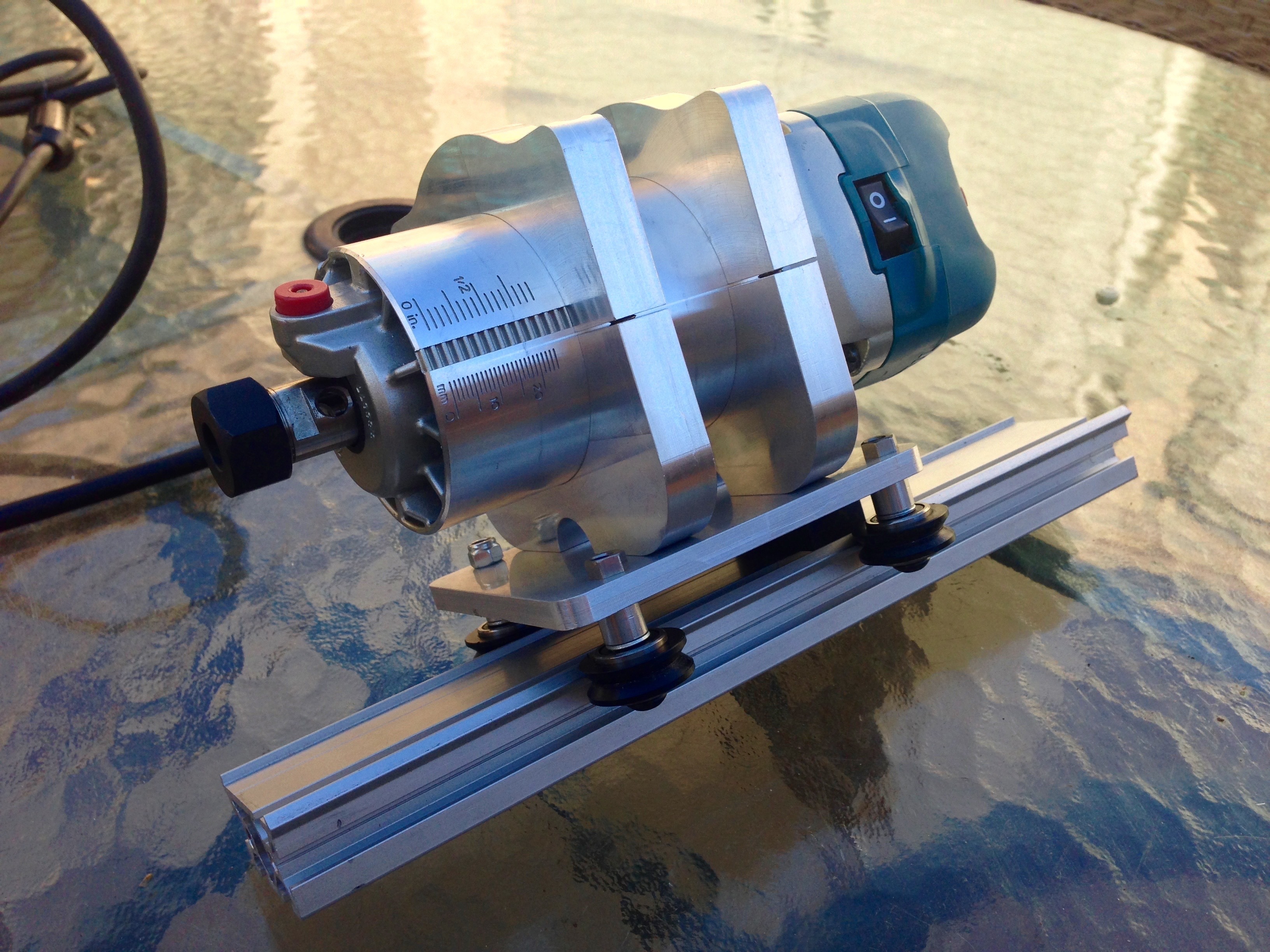

I’m considering a small run of a Makita RT0701 spindle mount and wondering if there is others who might be interested. The design is not complete yet but as soon as it is, I’ll get a quote for machining and have a better idea on price. These would be made from 1/2" aluminum tool plate and very strong. I have no idea on costs but I’m hoping to keep them around $40. But until I know more, that’s just a SWAG.

Thanks Yves. I havn’t been on the forums in a while. @DennisMartin@WarrenDownes, I have a test run at the machine shop right now. The initial test was for 3, of which two are spoken for, provided they work ;-). I could have an additional one added to the run, which should be enough for everyone. I can always have more made if I need. I won’t know what the actual costs will be until until sometime next week. I’ll let you know as soon as I know.
I picked up 4 of the spindle mounts yesterday and they came out great. I’ll post pictures here tomorrow. Two are spoken for I have two left, and 5 more on the way. It will be another week for the next batch.
The price on these will be $65. You get the new back plate, and the 4-piece spindle holder brackets. You will need four 10-32 x 1/2" - button head cap screws, and four, 1/4-20 x 1" socket head cap screws to put it together. You will also need slightly longer bolts for the v-wheels. m5 x 34mm or 35mm would be perfect. I can source them locally if you need, which will add $5 to the price.
